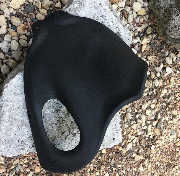

This might help someone, you never know.
Just changed the rear tyre and sprayed the "swinging arm bracket. Had a devil of a job getting the wheel off and on again. Damaged the brake shoes. Brake was completely backed off.
New shoes were the same until I took the sharp edge off the shoe material so they could have a lead into the drum.
Easy peasy after that.

I'm up for the swing arm soon, just finished a chin with the coating.

Thanks for the tip, you you. Just like removing and replacing the front caliper assemblies on your BCR. A little file action on the pads and the calipers slip right on and off. Ezee is good.

Yes. Just didnt think of it with the originals. Must have been a small lip. Last time I changed brake shoes was the early 80s :D
