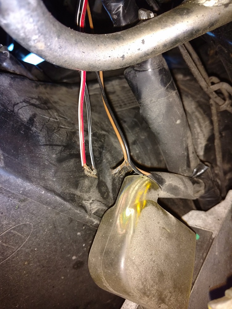

here is the best shot i have :
the brown and blackon the right are connected the red and white/black on the left are not connected with anything
any ideas of how it should be? Reminder: now the ignition is bypassed and the electrics just turn on once I connect the battery. also, the socket in the glove box does not have power when I connect the battery
thank you
thank you
Re: my pcx was hot wired
Now that's encoraging... The R/W and most likely the B/W are your ignition wires. So were they cut or torn away from the switch? See diagram... and I would get the black and brown separated looking for clues to how they were originally. Black and brown wires are also going to the combi switch and you can see they don't belong spliced together... separate them first.

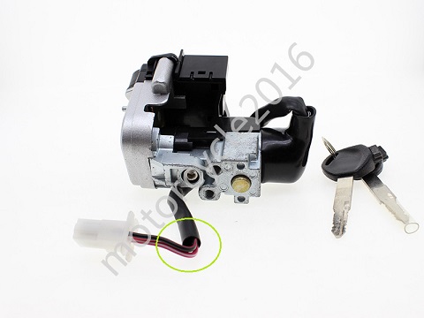

Hello, thanks a lot for the diagram. It seems that it is the 4 cables that are connected to the combination switch. It is in the up left side of the diagram and also in lower left side it is it's schema.
Here is a photo from the internet. I think it is this 4p connector.
https://www.google.co.uk/search?biw=168 ... zhJEChFRM:
And here I need your help. Any ideas of how it should be connected?
Thanks
Thanks
You are unable the identify the original configuration of the wires? Even with their colors? Not sure where the damage is but I imagine it to be within the line I circled. Is the connector completely gone or still in it's receptor with cut wires sticking out? Without I tear mine down to see where this connector is located I can't know. The SM does not have a actual photograph of this connectors location.
You should be able to sort this UNLESS the male end of the connector has been removed from the female end and cut completely off and no where to be found. So to be clear do you see the white plug in the picture still inserted in it's receptor? If so unplug it and go about the business of soldering and fixing each severed wire to its mate. Plug it back in and fire it up one stage at a time watching for familiar dash activity before starting the engine. Mind your fuses as you might blow one. This would be good indicator you crossed hot wires in the process, so work with battery disconnected.
