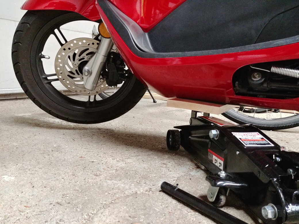

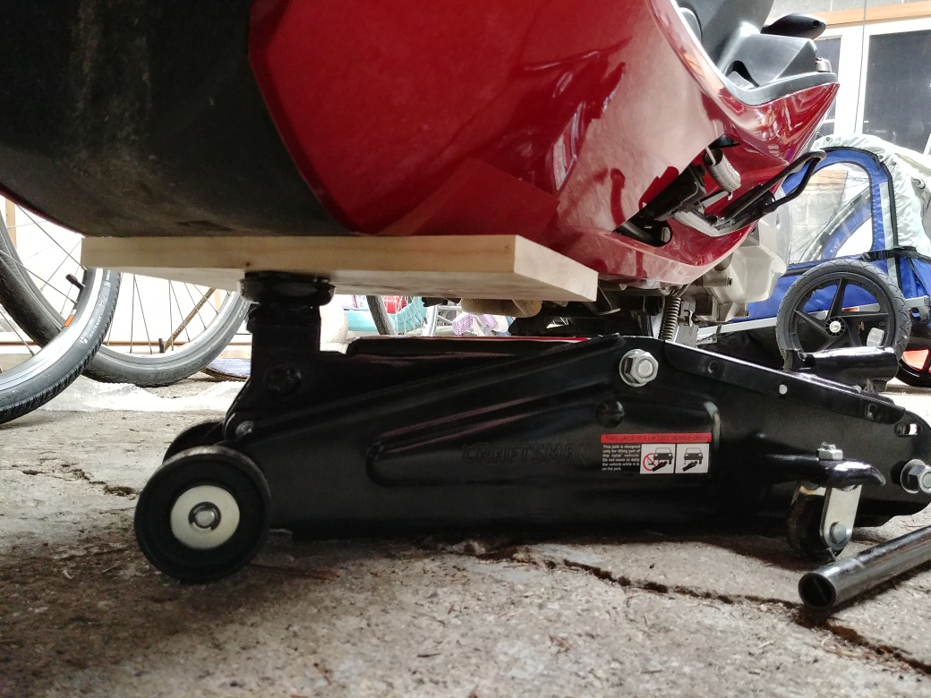

I went out to the garage, got my floor jack and a 1x6 scrap and put it underneath and across the bottom of the scoot, near the front. It was VERY easy to get the front end an inch or two off the floor.
Without the weight of the muffler and rear wheel/tire, I wouldn't think there would be much chance of it tipping backwards, using this method. Or from using a prong-type front stand: http://www.discountramps.com/front-moto ... /BW-10-V2/
fish: to your comment about replacing them one at a time. and the rear wearing faster. I'm not down to the wear bars on either the front or rear tire, but I'm starting to see some age cracking in the treads, which worries me a bit. Makes me think they probably will not stick as hard as they should, in case I get into a panic braking situation. The bike has around 7k on it, and I presume they're original tires from 2012 or 2013.

Re: Cheap front stand; What're you using?
That hydrologic jack might lose pressure after awhile!
That's why i suggested the screw type scissor jack.

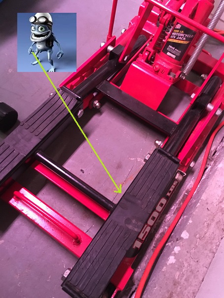

I envy your big bike lift WN but I have no room.
- lift.jpg (118.27 KiB) Viewed 4675 times

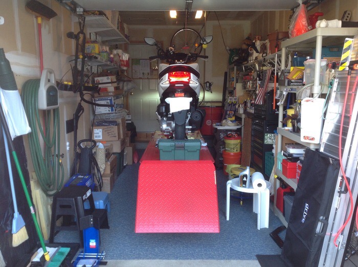

You call this "having room?"
This is a one car narrow garage. I pull bicycles out onto the driveway when working on scoot. The scoot is always on the lift. I removed the chock that came with the lift and installed a condor scoot chock in its place (drilling involved and longer bolts). Haha, I ended up removing that chock too and just use the center-stand now. No wait! The base of the condor chock stays in place on the lift, it's upper parts are easily put on and off. Those parts are off now.
See Condor front left of pic. Right front - 3 different length ramps, siphon and lotsa stuff. Orange cones for above for Kiddies in family on bicycles. I have them riding around them. Training 'em young
What a deal harbor freight runs on this lift! On sale several times a year it was a no brainer for me. Not many parts involved. I enjoyed the Assembly. Prep and Buy pump oil. Mine was bone dry. Check first folks - Do not attempt first lift without it!
Look at All this Room I have homie. You have a 2car correct? I did have 3. Miss that Big time!!
