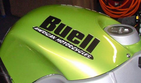

The color i'm after will have some pearl essence or bling as in the picture but I don't know this business... yet 8)

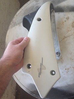

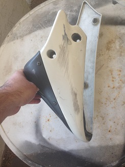

Thanks, is it just a given they will paint the undersides? There are seven pieces in total and i'm about to find out what this will cost. The rag tag collection of used parts need some professional attention that's for sure! Here are the before images.

Nothing is a given in the service business. Tell them exactly what you want them to do, and they will do it.
