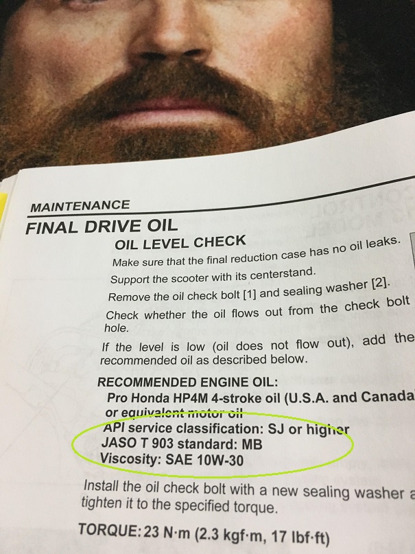

Just bought this scooter,on the way home i stopped at the Honda dealer to buy some oils and coolant,i thought i read here to use 10 w 30 in the final drive but they sold me Honda Honda hypoid 80/90 is this right,the scooter only has 5.8 km on it.

So what should i use,10w40 in the engine,but what for the final drive?
Re: 2013 PCX 150
Welcome sir chappy!
I don't know why Honda tells people to put that heavy gear oil in the final drive. Not the first time we've seen this. You would think the guerrilla's might read the service manual. I will link you to SM when you have more posts (sorry it's a forum thing). For now here are your recommended fluids for your bike and the owners manual in case you didn't get one from the gorillas. Thank you for putting your year in the profile, please add your location as who's knows if you can even access Amazon

Oops.. you are talking in kilometers so I hope the items shown can be found in your country. Chicago here RA! RA! go Bears! The little Honda like fluids with Moly in them per the service manual but I know some of you can't get this additive in your countries. Remind me to shoot you the service manual after you post a few more times. You could put up some pictures... we like pictures of scooters

Thank you homie,i was sure i read that here now i know,will use the 80 w 90 in the outboards,got to get a service manual

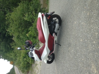

Hello,will try a pic,got a 147 km on the clock,what a blast fun to ride.
Sold my sportster and bought this,should have done it 5 years ago.
