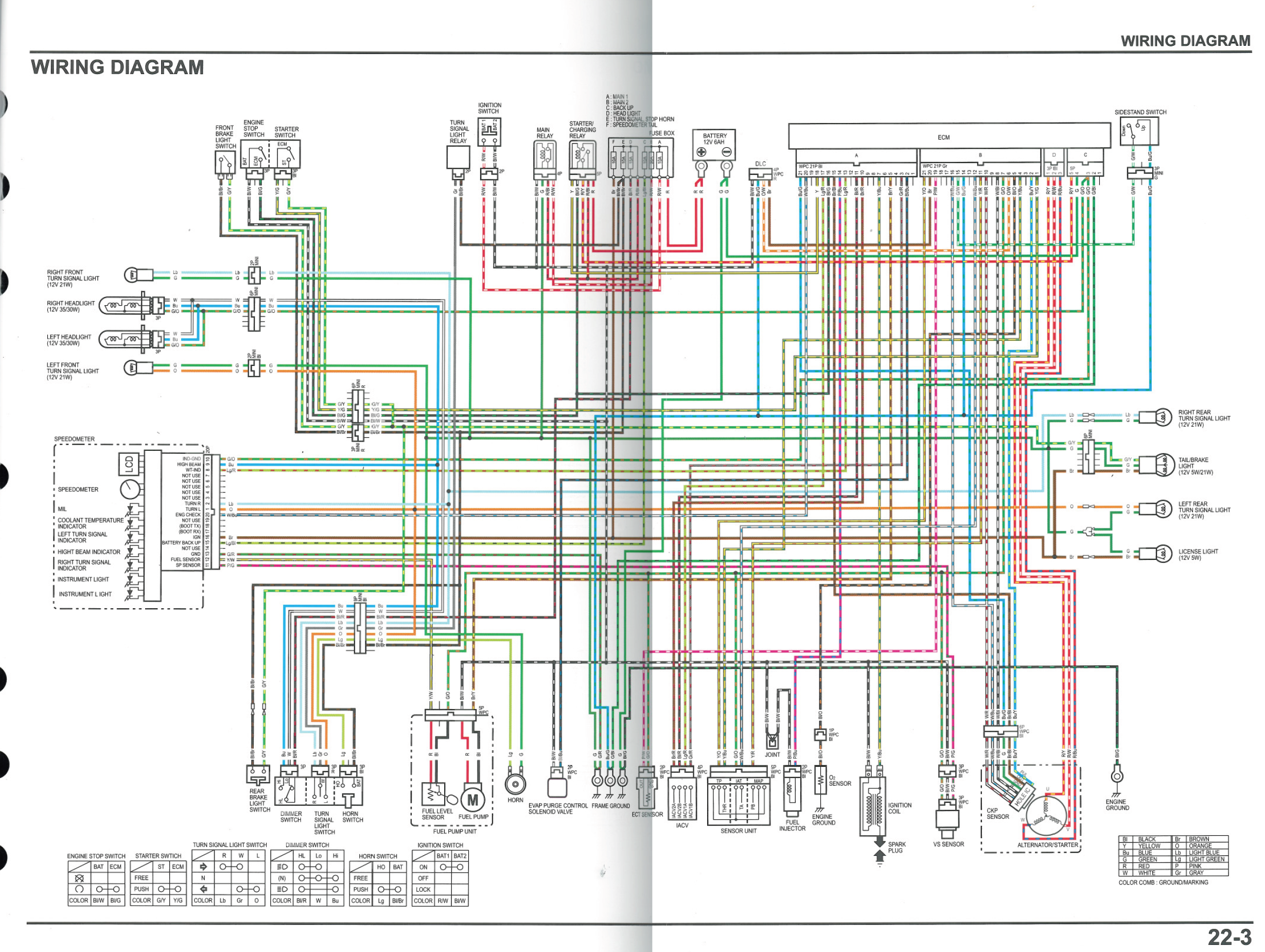

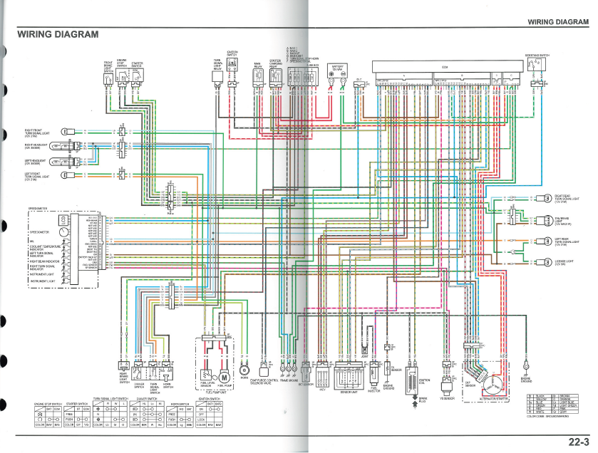

The attached should help anyone wanting to wire in any mods to their bike, or help anyone track down electrical issues. The PCX has a lot of wiring, so the full diagram is HUGE!
Below is a preview:
wiring diagram preview.png (480.51 KiB) Viewed 113927 times
And attached (download by clicking below) is the full diagram:
Honda PCX Wiring Diagram.png (3.51 MiB) Viewed 112565 times

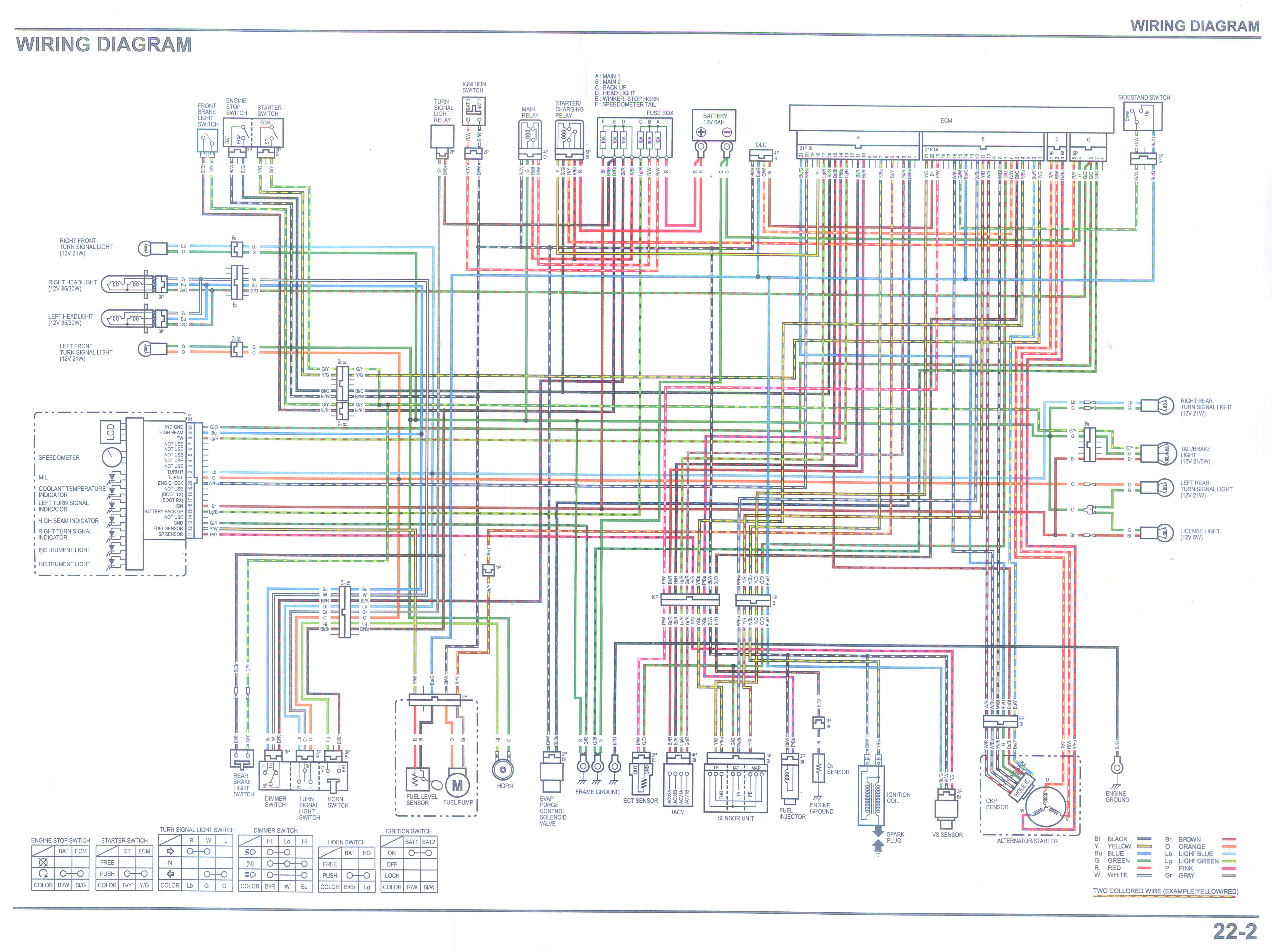

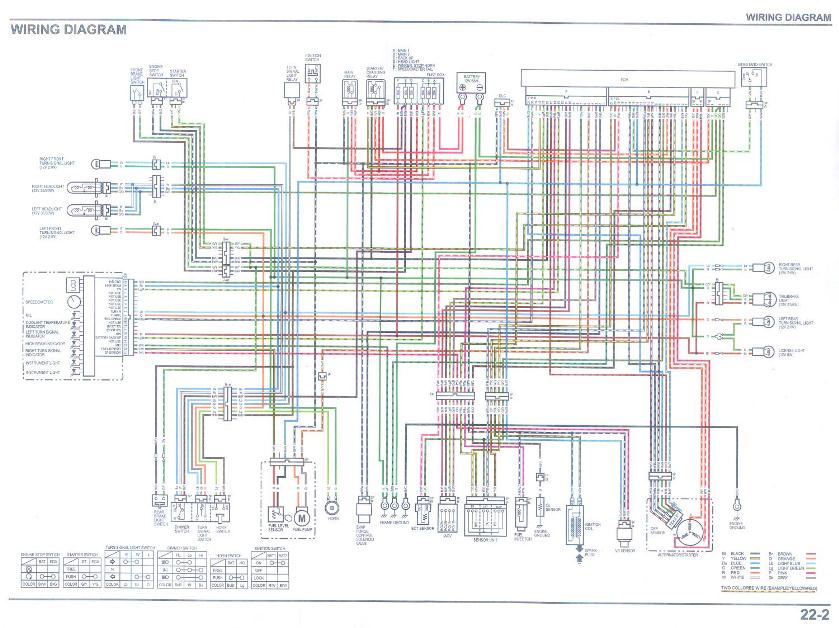

Thanks to Fritz, we now have the PCX150 wiring diagram as well. Below is a preview:
Honda PCX150 Wiring Diagram Preview.jpg (95.11 KiB) Viewed 113196 times
Honda PCX150 Wiring Diagram.jpg (1.24 MiB) Viewed 112565 times

Interestingly the green/orange wire goes from the speed sensor to the ECM (Engine Control Module?)
Speed restrictor...?

Well it's a sensor feed to the ECU. Could be used by the ECU for many things after that. Stop start would be one of them

True, essential info for the stop start system.

Is there a change for the 150? or is does this work for both models?

This is for the 125 -- the 150 might be different.

Thw blue/yellow wire coing from the ckp sensor is what the engines revcut is., if my knowledge is correct.
It is a fuel cut. Not ignition, for those who were wondering.

so where can i locate the switched live physically on the bike? Also for ground, shall i use the battery or the bike frame?

Thanks to Fritz, we now have wiring diagrams for the PCX150 as well. Thanks Fritz!
