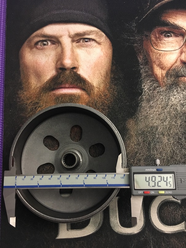

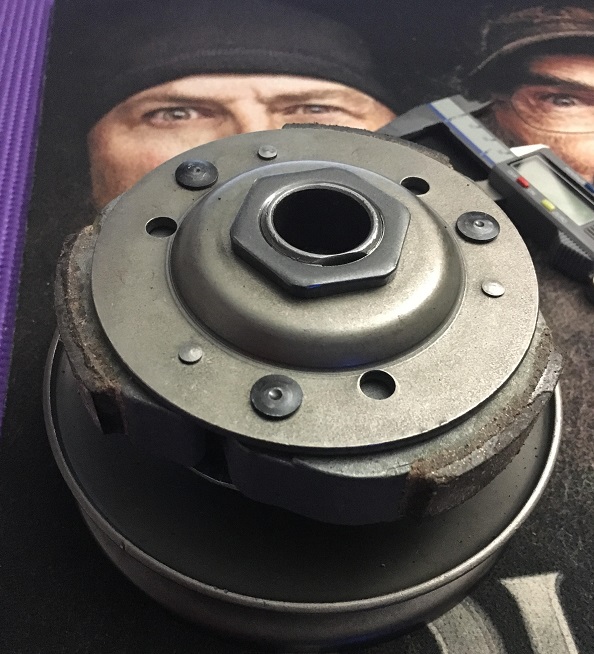

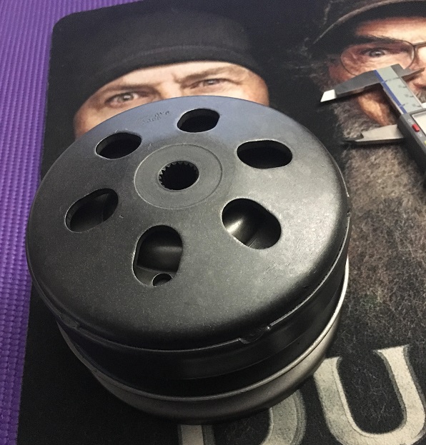

Reviewing non-OEM compatible parts from various online sources that are priced too good to be true but may be the same part.
This is an entire pre-assembled clutch pack that meets the service manuals specifications from ebay for 30usd shipped from Texas in two days.

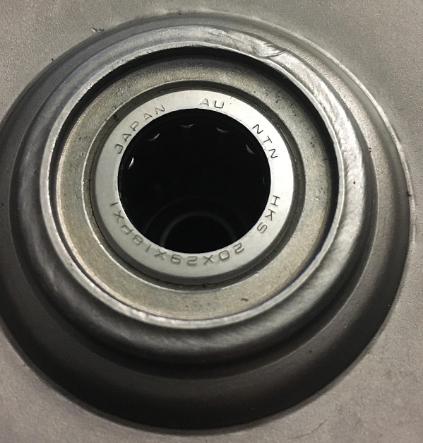

Assembly (including the otter bell) is 6.4 pounds clearly the weight and quality of the OEM product. The shoes look great and the bearings are stamped (Japan). The 19 tooth count is a match. No where on this product or packaging does it say China.
YOU MUST ADD 7 GRAMS OF QUALITY GREASE BETWEEN THE BEARINGS, FAILURE TO DO THIS WILL RESULT IN LIMITED SERVICE.
http://www.ebay.com/itm/CLUTCH-ASSEMBLY ... 9~&vxp=mtr
I would consider this (plug and play) pre-assembled clutch pack over buying the individual OEM parts and the 50 dollar tool to assemble them. IMO this is the same part 8)

It's going to depend on your riding habits. I would suspect some of us will wear out the shoes faster than others. I wouldn't worry about the NEW items on ebay, they don't expire, no bidding always going to be sold by somebody. I bought it to know if it was compatible then to use someday if it was or give it away. Personally I trust OEM parts and don't mind paying for them. The variator and rollers came in today, haven't had time to evaluate the shipment yet. I can tell you it does not look right to me.
But that clutch link by that seller right at this moment is a compatible PCX125/150 all years part that is complete and pre-assembled. How easy would it be if you need one of these to swap out yourself and keep on trucking 8) YEAH EBAY!

Yes spring installed, nut torqued BUT NOT GREASE PACKED. I'm 100% sure the one I bought from that seller at that link will fit and perform like one from Honda. I add things to 'my collections' and over time the seller will sell out and ebay will redirect you to another seller for seemingly the same item... don't trust that. You will have to do your research and take your chances all over again.
