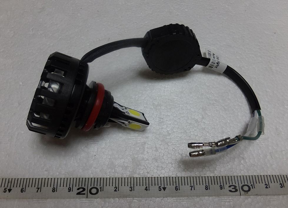

I would like to change the headlight to LED.
But I have a question on the DC / AC...
I am going to replace the headlight to this LED light. Is it I additional need a AC/DC converter?
Thanks a lot!

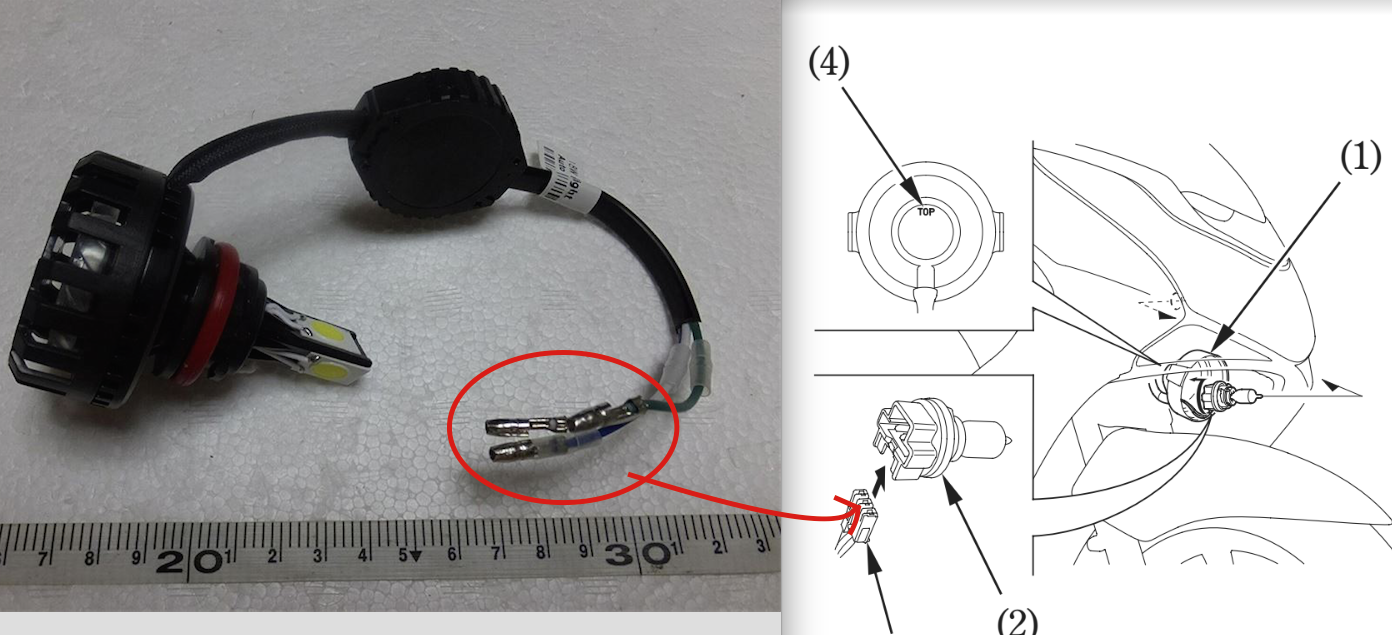

so does it means that after removing the original headlight bulb, i just need to connect the 3 pins of the LED directly to the original socket like below photo, then it's OK?
I have done exactly that. Changed round connectors to flat ones and they fit original socket so I can switch back to halogen lights if needed.

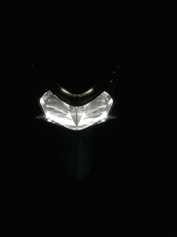

i just finished changing to LED, and yes it's quite easy...
i bought it from Amazon JP
