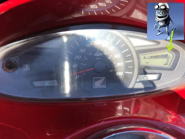

Apparently there was a lost shipment of these faster 2013 PCX's that drifted around the Indian Ocean up through the South Atlantic and finally washed up 4 years later in container's on Jersey Beach. They didn't know what the hell to do with them because they only ride vintage Vespa so they shipped them to Wisconsin
https://appleton.craigslist.org/mcy/6125594069.html
- 00R0R_5BjQFNXnSp5_600x450.jpg (60.13 KiB) Viewed 4811 times
