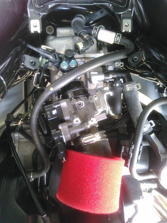

May I know if any PCX rider here install Wiruswin Hyper Valve?
I just bought one but my bike shop say if i want to install it, i will need to do some cutting on current pipe which he doesn't recommend
so i hope if any rider here have it install on their PCX and how to install this item

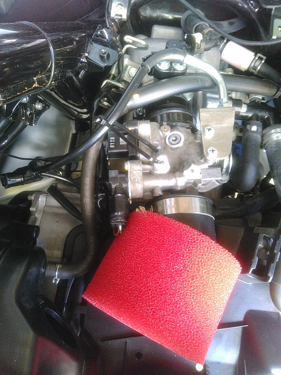

Yes, I have installed one on my PCX150, and PCXdemon might still have one on his PCX125?
So, I'm going to be very blunt - your bike shop isn't very good...
Heck, you can vent to a baby pod filter...
There is no cutting involved, but I rerouted some things. I removed the bracket that used to support the hose.
Look at the attached photos of my test install with a 31mm TB upgrade for an idea of one way to install it.
My final install was pretty much the same, except I had a zip tie to prevent the hose chafing on the chassis (top right).
As for the valve's usefulness? Hmm, I could not perceive any difference. But Yuminashi recommenced it for my BBK install.
PCXdemon suspected his valve might have been allowing some oil to go into his airbox. But I've not seen any such problem.
Ignore my red pod filter, it is temporary until I get around to making a big intake tube mod work with my stock airbox...
Have a good one, Gav.
