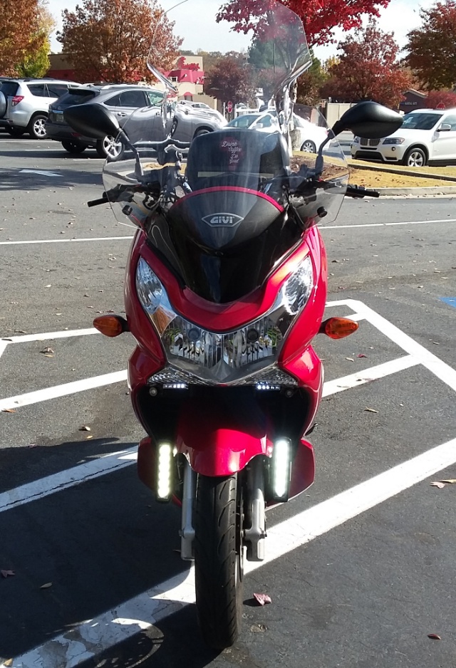

Here is a front picture of my bike. Notice two little LED lights under the main headlights, and the two LED spot lights , one on each side of the front wheel. Those are controlled by the switch on my handlebars. The little LED lights under the main headlights are now spliced into the main lights so that they come on when the bike is started. I also have some small strobe lights attached that you can barely see during the day, but are great at night. Hopefully this picture will give you some ideas.

For some reason this picture makes want to get out riding again :D
Hey Mel, really nice looking set-up on your PCX. Thanks for the suggestions on the LEDs. 8)

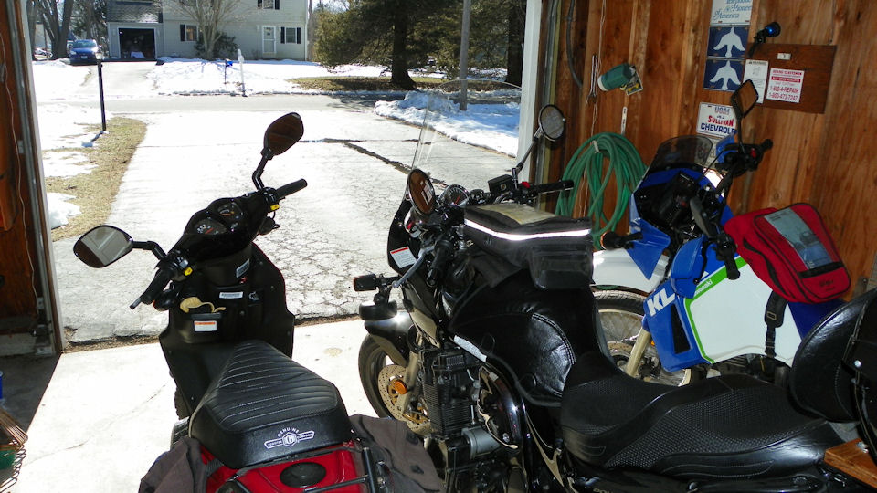

Was finally able to ride the scooter yesterday and today. . .temps in the 50's range and snow melting quickly. . .but not quickly enough for me. :lol:
Had to give the KLR battery a quick charge before firing it up. The Bandit started promptly (new battery last year). . .not riding them until the roads are salt free and dry again though. Just running the engines every now and then and using the scooter for daily errands. Got to give that a wash later this week.

This add of LED lights to the front is really a simple install. The reflectors come off and the lights bolt on, hook the wires to a good ignition triggered source under the front dash area. I chose the floods for daytime visibility.
The bike charging system will take adding front and rear lights fine. In the back, I added a VOLOLIGHTS plate frame that triggers strobes when braking.
Good idea installing those LEDs down low on the forks. Look's like Mel has the same ones. It not only lights up the path better but it creates a taller image that would stand out more in traffic. An oncoming vehicle may take a second look wondering "What's that?" instead of just seeing lights. :?
