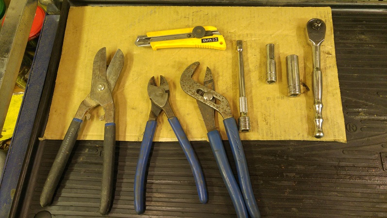

Lets start with tools needed:
ratchet driver with medium extension 6" ideally
10mm socket
14mm socket
pair of adjustable pliers (also known as 5 holes)
side cutters
knife
copper grease
anything else you think could come in handy

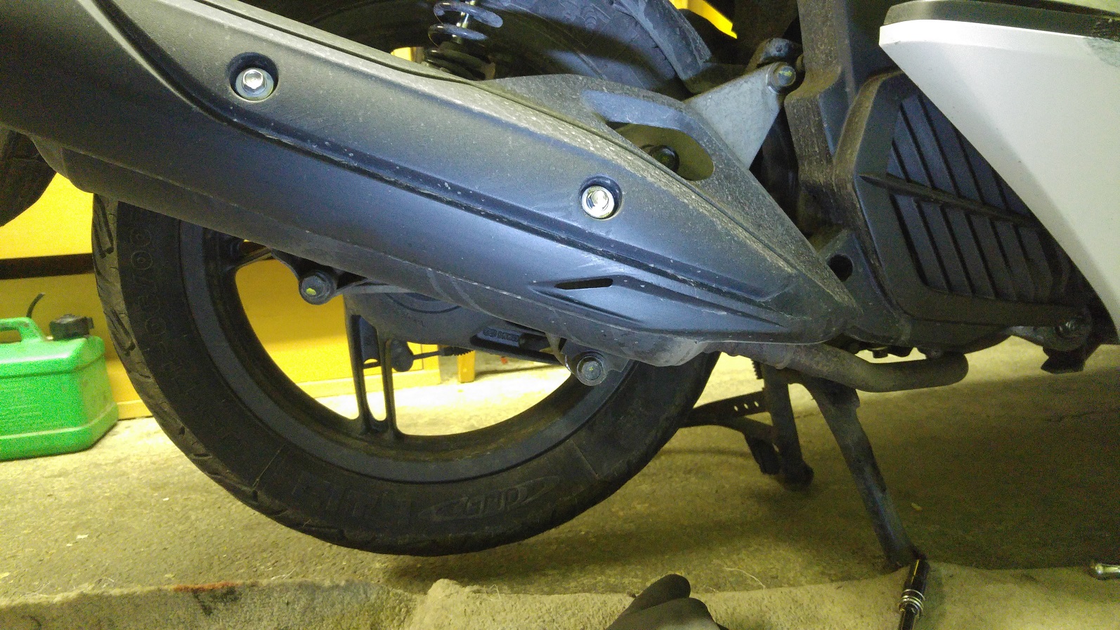

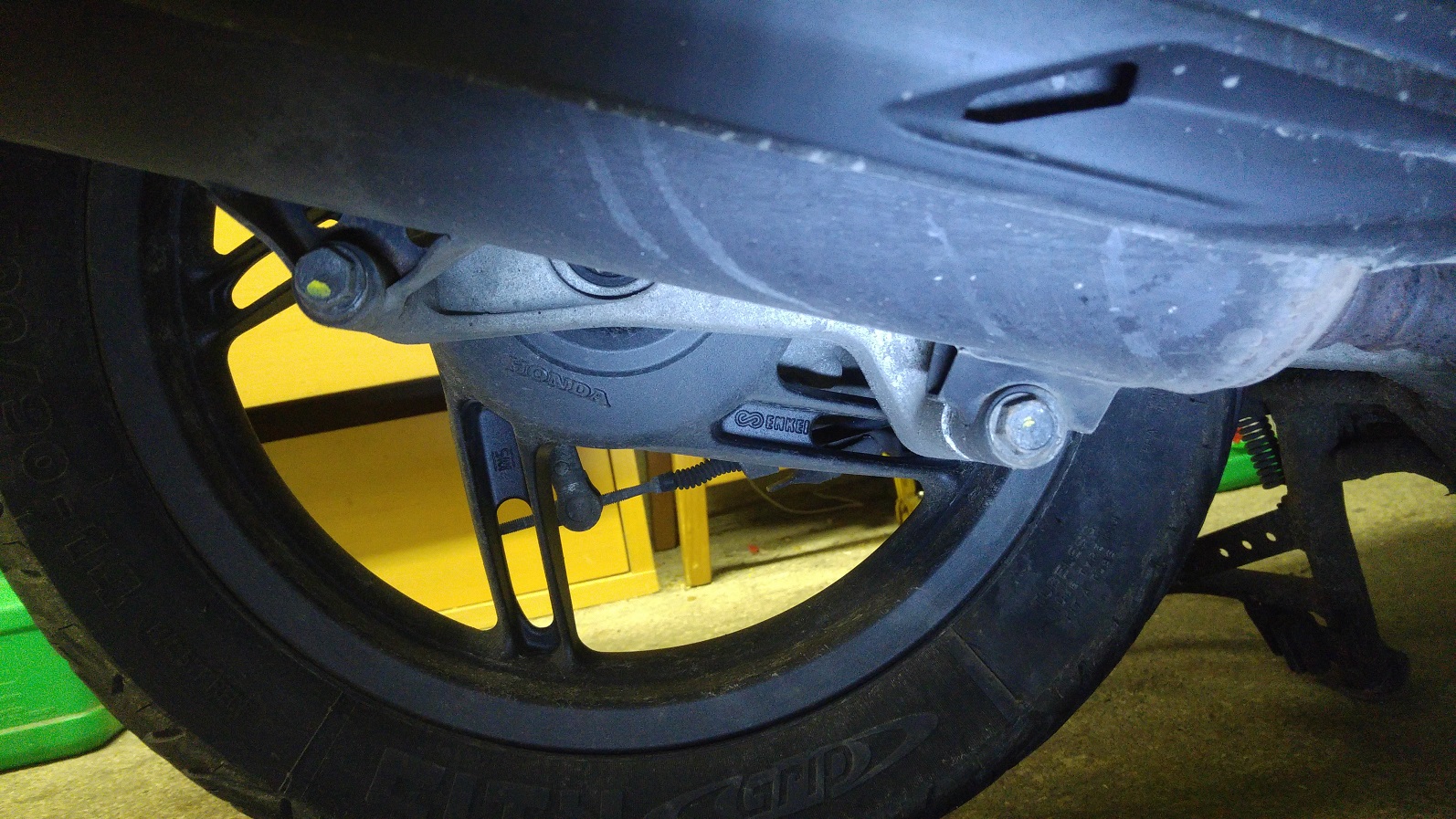

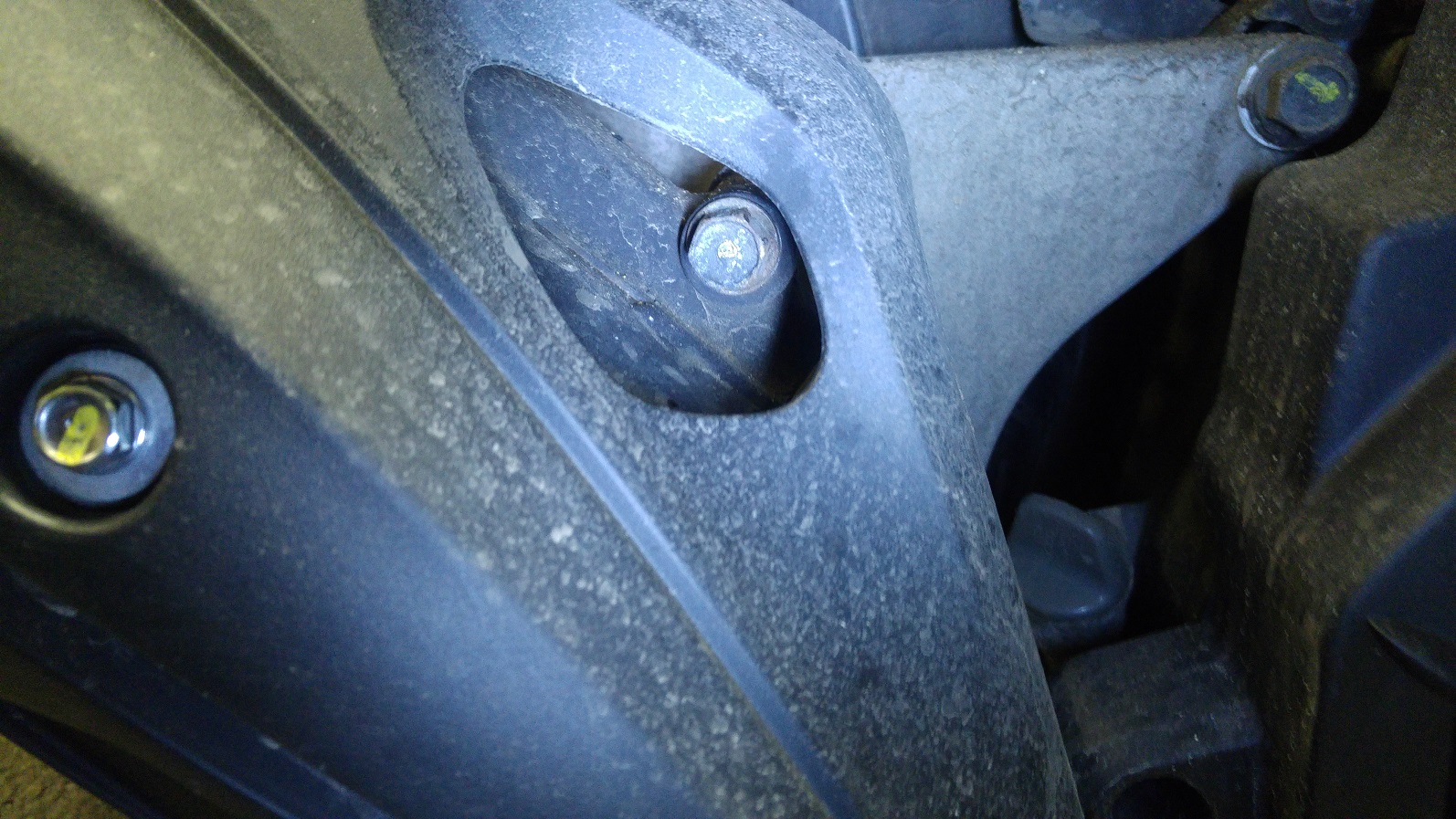

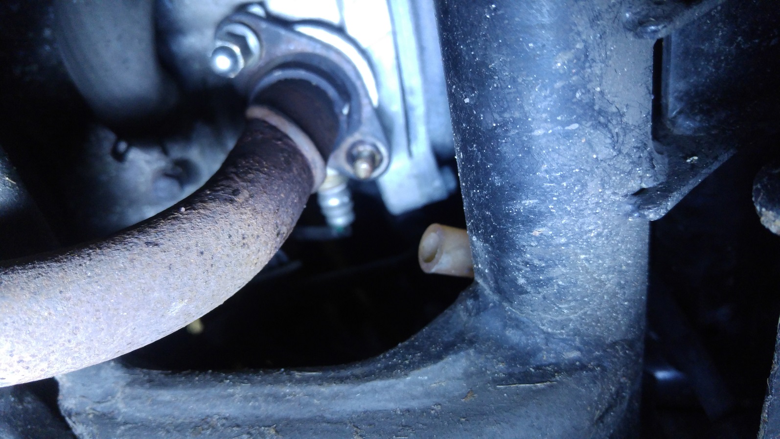

Lets start taking exhaust off:
Two 10mm nuts underneath bike
three 14mm holding it from side
one behind guard
one behind guard
two underneatch
two underneatch
take plastic cover/guard off

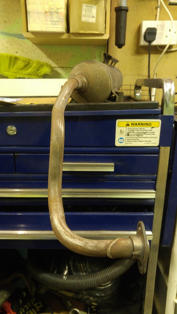

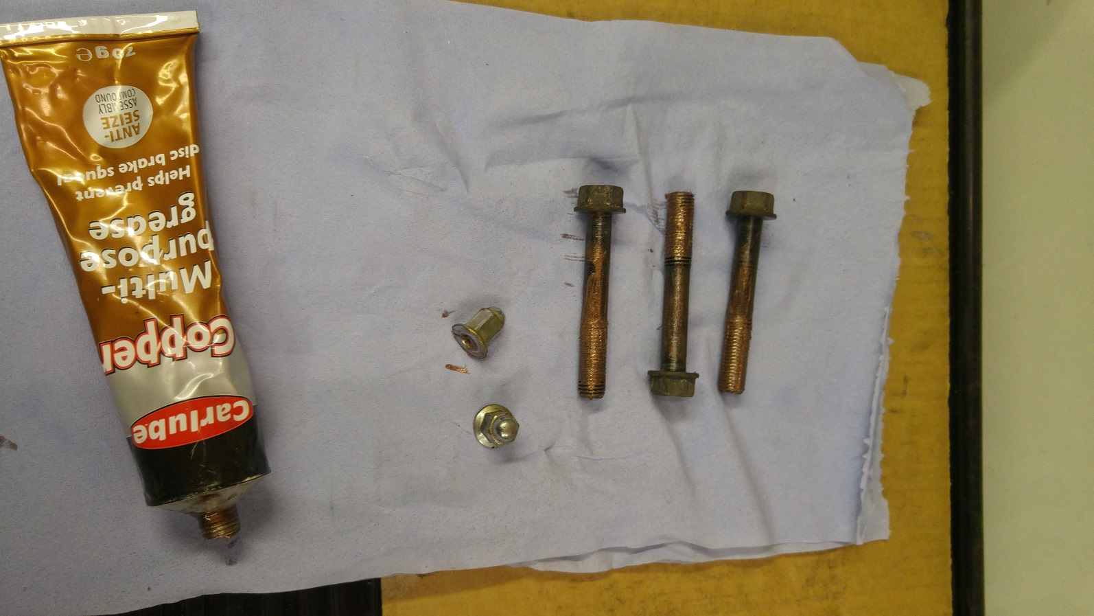

I've cleaned pipe from surface rust as much as possible
putting bit of copper grease on all bolts and nuts at the same time

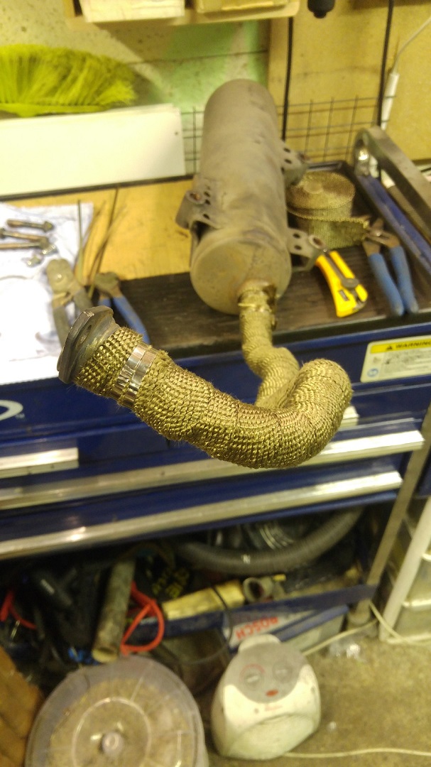

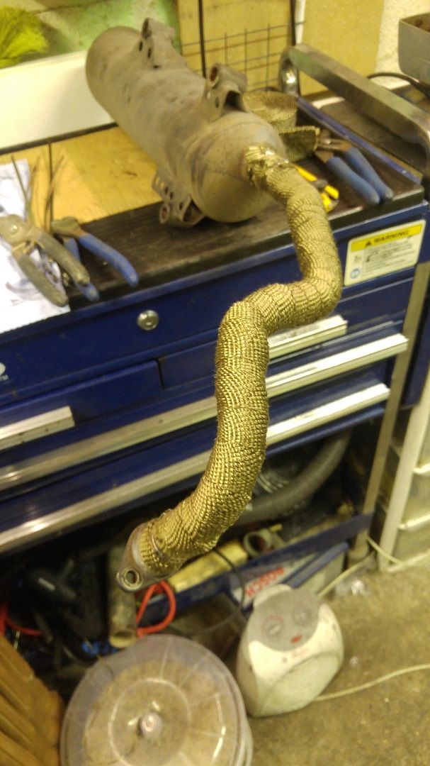

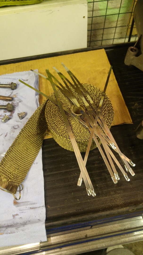

Ok so latest ebay purchase
now this is when could've done with some help but wife was busy
start wrapping, keep it tight and put metal clamps at the same time - good luck
I've put two metal ties at the beginning and two at the end to be on the safe side

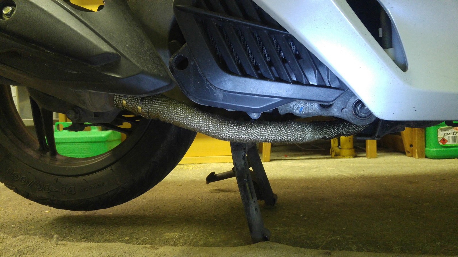

And place back on bike, well happy with final result

Ok, question for those in the know. Is there a bottom aero panel in some markets behind the plastic? Sure appears to be attachment points there.
May work on fabricating one out of aluminum to keep debris from hitting the wrap/exhaust.
