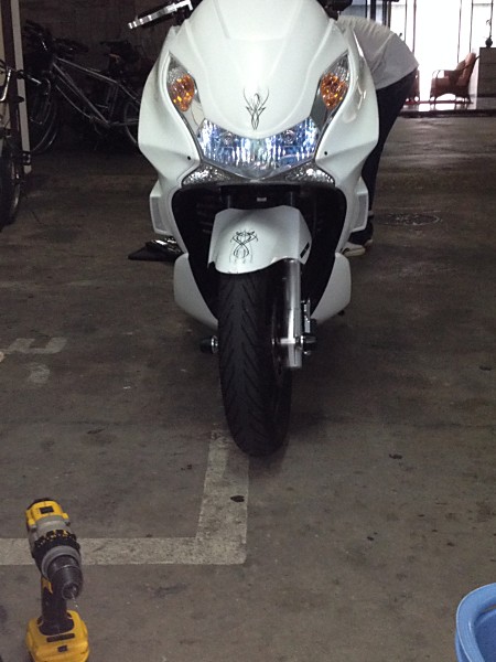

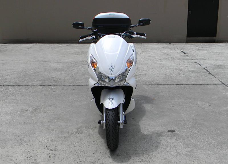

easyrider wrote:...... I would like to see a pic of another front city grip on a bike and check it...........
Here a couple ...
2013-10-07 16.27.00_800x600.jpg (62.94 KiB) Viewed 3652 times
PCX 001 C_800x600.jpg (60.84 KiB) Viewed 3652 times
Re: Tire issue ? or Not ? Question
Posted: Tue Jan 31, 2017 5:21 pm
by easyrider
Yep, thats the way mine look too..I changed out the rim, tire, and rotor.No changes.Still has a shimmy or slight wobble when I apply the right hand brake only . Only happens when I abruptly apply the front (right ) side . When they get warm the stopping is much smoother and minimal wobble. I believe something to do with the front caliper. Next time you go out check your right side hand brake and apply it to an abrupt stop(no skid) and see if anyone has the same shimmy. Interesting ??
