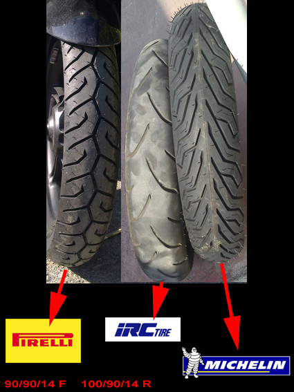

Re: Puncture
Posted: Mon Nov 14, 2011 2:09 pm
by edscoot
What are the tyre names? Pirelli told me that don't make a tyre to fit the pcx (the diablo mentioned on their website isn't yet produced). I've looked for michelin in our sizes on ebay.co.uk and .com as well as michelin website - no joy. The only results I get on ebay for these sizes are IRC.

IMO the IRC ones are cheap... and if you're going to replace the tire every time you get a puncture, IRC will save you some dough. This WILL happen again... I've probably had 10 nails in motorcycle tires, and only 2 or 3 in my car. The small wheel base makes them more susceptible to damage.

Phoned the tyre shop today to make sure he had the right tyres and he assured me that he had recieved the tyres this morning
and that the sizes are correct. The tyres are Michelin City Grip (it seems the michelin web site needs to be updated). As for the stock tyres on ebay once you add on postage, fitting and balancing (unless your able to do this yourself) , cheap tyre's are suddenly
expensive as i would be paying the same money for a lesser brand tyre. Anway i'll find out for sure on thursday when i've got time

That Michelin looks good with all those sipes. Let us know what you think of them.
