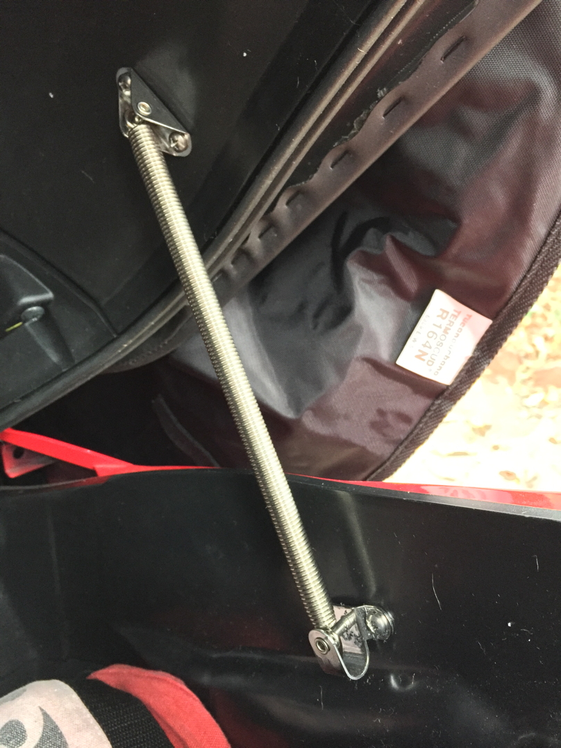

My seat damper was replaced under warranty, and my experience matches that of others here. The new one still doesn't hold the seat up when it is cold out.
I installed a marine hatch spring to hold the thing up:
http://smile.amazon.com/gp/product/B00GXI4RBG/

Yep, short pan head screws was all I used.
I will try to remember to post pix when I get the beast back.

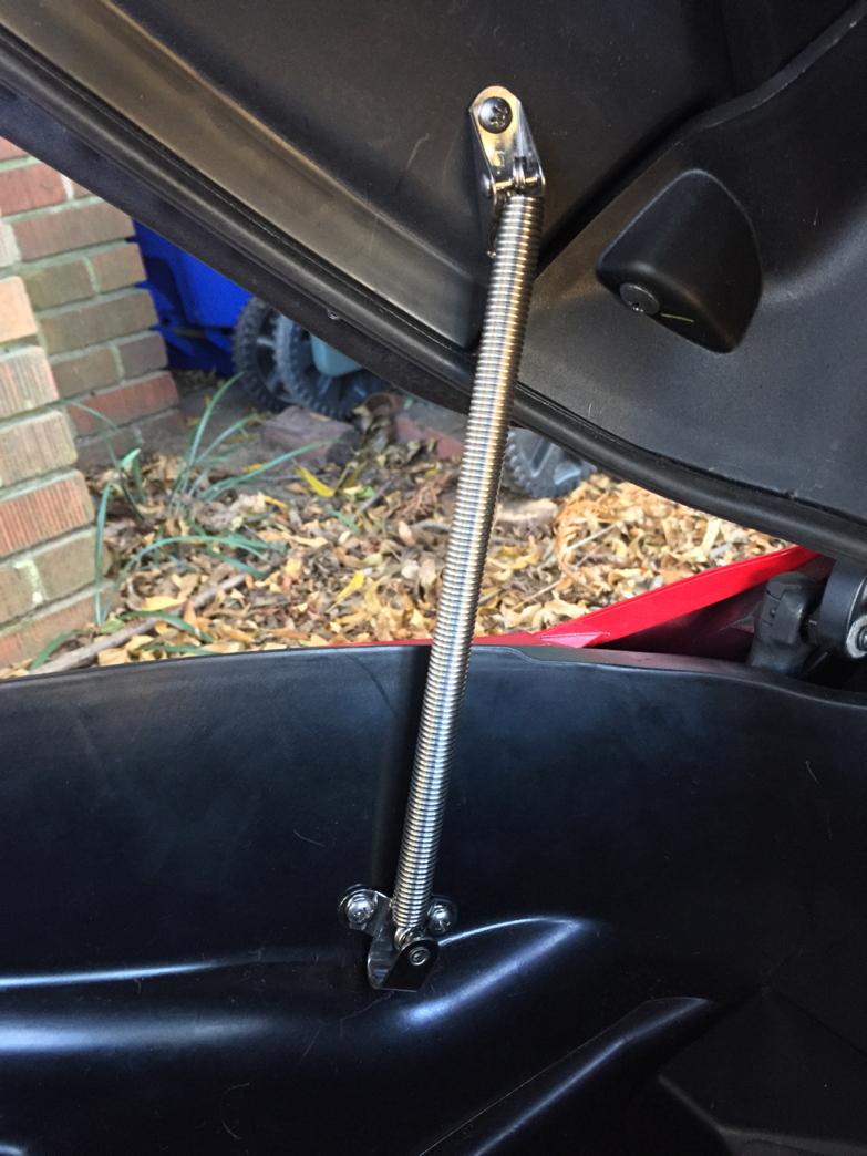

I actually got the bike back on Tuesday, but it was dark when I got home, so no pictures that day. Wednesday after work I snapped a couple of cell phone pix, but haven't had the time to edit them to the board's maximum size until tonight. (OK, I might have had time last night, but we went to a Bob Dylan concert instead.)
This is not a perfect fix. In cold temps, I have to open the seat all the way so that the spring straightens out. This means that I have to reach down there to the front end of the seat and tap the spring to bend it before I can close the seat. If I don't find a different solution, I will probably move the spring to the other side of the seat so that when I go to tap it we are both on the same side of the scooter. I'll still have the awkward reach, but at least I won't have to reach across under the seat to do it.
So, if you decide to try this yourself, consider putting the hatch spring on the right side instead of on the left side like I did.
But I'd still prefer to find a different fix. So if anyone out there has a good one....
Be that as it may, here are a couple of pix of the current install.

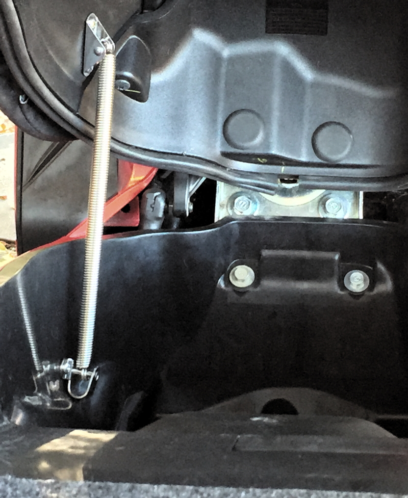

OK, among the to-do list items I took care of yesterday was moving the hatch spring over to the other side. Pulling it off of where it was, drilling pilot holes, and installing it where it is now was a five minute job. I am much, much happier with the thing on the right side of the bike. The only times this will be less convenient are when I'm hanging a helmet off the left side (which is very infrequent; the helmet normally goes into the Maxia box on back).
Here's a picture:

MBMyer...thanks...wonderful...works a treat..seat now stays up!!
took me slightly longer than 5 mins as its fiddly...but easily done.
