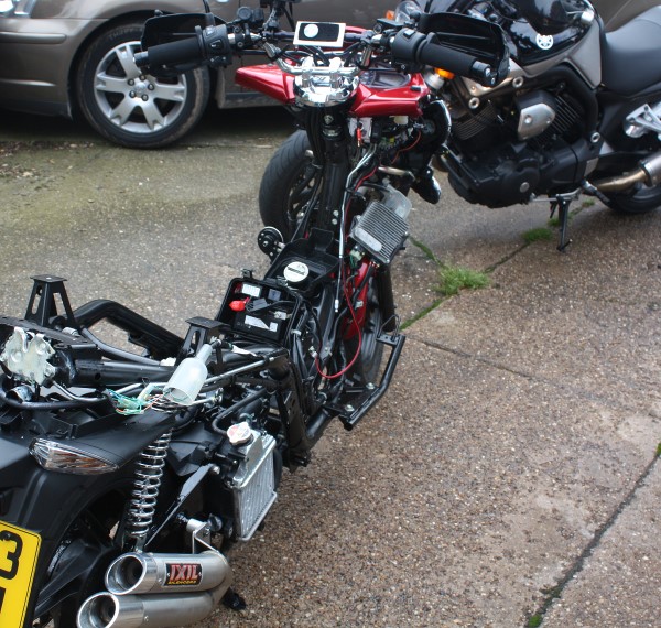

Over the last week I have
Checked the valves, inlet too tight so adjust.
Installed heated grips.
Charge indicator LED.
Fork gaiters.
USB and power socket.
Alarm
LED light to illuminate ignition switch.
Rev meter.
Power supply for GPS.
Painted engine and forks black.
Oil change, transmission and engine.
Touched up the metalwork and wax oiled everything not visible.
Just got to assemble now, nothing broken yet. :D

"Why am I doing this now", well I have had all these bits for 2 years (except the alarm), I do like to plan a good job though my friends think I'm just a lazy C*&t.
Kitchen sink, still not found the right one. ;)

I wouldn't mind seeing a side view pic of the forks when it is put back together.

Where did you get the gaiters from?
Re: Getting ready for winter
Posted: Wed Sep 07, 2016 1:38 am
by DAB
you you wrote:Sensible mods for over here.
Wemoto,
The following items from your order have been dispatched.
1 x Fork Gaiters Small Black 21.5cms Long 28-46mm ID - Ariete 07907

Finished, Gaiters fit perfectly.
Posted: Thu Sep 15, 2016 12:00 pm
by DAB
No damage to any panels, used lithium white grease on all tabs. Easy.
