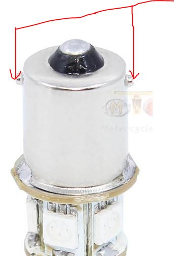

I have a question on the type of tail light bulb.
May I know that the "leg" of the bulb is 180° or 150°?

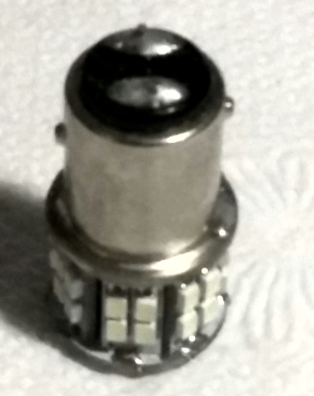

Re: LED Tail light bulb, 2013 PCX150
Posted: Wed May 24, 2017 9:24 am
Led 1157 bulb.jpg (135.25 KiB) Viewed 4238 times
Here is the bulb itself. I do note right now that the connectors are pretty wide. I don't know if this is normal for led or not.
By the way, the legs look 180°.

by Cyruscmh
Mel46 wrote:
great, it helps a lot!
because when i was trying to replace the signal light bulb, and just release it is 150° type...... :?
