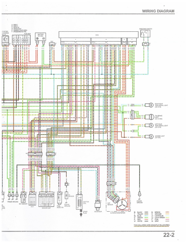

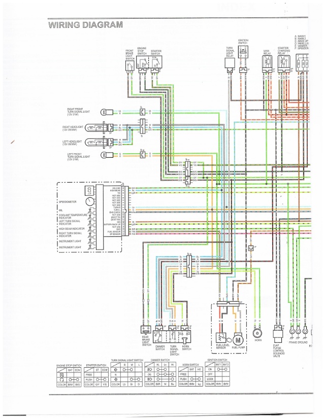

I had mine apart a few months ago. Sorry but I didn't take any pictures. If you have the wiring diagram you shouldn't have a lot of trouble. Somewhere on this forum I added a picture of the wiring diagram...somewhere... :-/
By the way, the turn signals go to a point in the wiring harness where they can easily be disconnected. Each of these accessory items has a quick disconnect for quick disconnecting when changing out the panels. In fact, the wiring harness is a series of quick disconnects, so that replacements can be installed quickly. Once you get the front apart you will see what I mean. Just keep track of what plugs in where.

Mel, yours is, in fact, the very diagram I had looked at, which prompted me to inquire about the difference between reality and schematic.

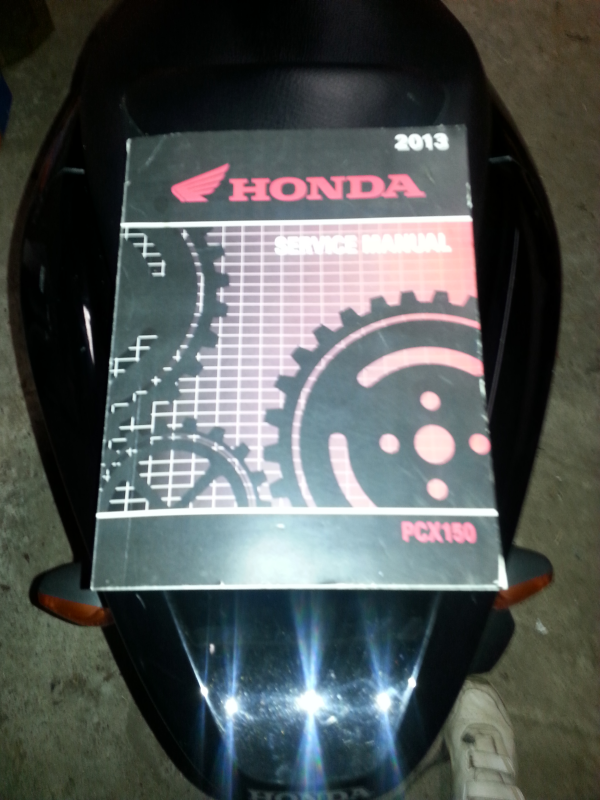

Well, I do not have a wiring diagram inside my Shop Manual.
Purchased from Helm, back in May, for $40 or so. Came shrink-wrapped.
I can see where it was supposed to be, but there's nothing there except for a dried-up glue stripe. Apparently, this manual was not put together correctly at the printer.
I am in the process, as we speak, cleaning up and redrawing the wonderful image that Mel put up, so I can take it to a print shop and have them print out a nice, clean, crisp 20" tall poster for me. To be taped to the wall of the Lair. Near the poster of Natasha...
This is the manual I have:

Ish, I hope the new copies I have just sent to your pm are better than the one you presently have....so just maybe it will help you. Sorry you didn't have a copy in the manual.

Mel, Iif you are feeling industrious, I wouldn't mind a copy of the diagram as well. Don't need it right now, but someday...
Re: Theory vs. Reality, or Schematic vs. Physical
Here you go.
