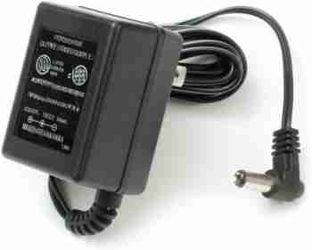

The second question is a little more mundane, but rather odd in its own way. I am going to be fiddling with LED strips here in the near future, and while I don't mind walking out to my car to check whether the things light up via my car battery, I would like to have a way to bench-test them right at the bench.
Could I take a 1v DC adapter and use it to check the lights?
What I have in mind, is this:
- power 1.jpg (5.69 KiB) Viewed 3792 times
I have several of these laying around from old printers, old cordless phones, and the like.
I thought I’d snip off the little round connector plug thingies, and use some of that metal glue wire (the kind that comes in a little coil, and you have to melt with that pointed electric pencil thing) to stick on a couple of those little metal squeeze clips, so that I can pinch the ends of the wires from the LED strips to make them light up when I bench test them.
I wanted to find out if what I’ve done will light up before I go too much farther and start another fire. Those times when things go “poof” with a flash of light and puffs of magic smoke are kind of rough on my nerves, and I don't know if this idea would work. My major concern is that I don't know how to tell with a multi-meter which is positive and which is negative of the pair of little wires that go into the round plug thing. Does anyone know how to check that?
Would one of those power supply things work for my purposes? Again, Does anyone have any experience with that? Any ideas at all?

If you're testing LEDs for scooter lighting you need a DC converter with adjustable amperes, that AC wall adapter probably won't work.
The PCX is 12V/6A from the battery, not sure what the alternator bumps the amps up to. But a small battery like the guys said sounds easiest.

Okay, who's going to buy the small battery for me? They start somewhere around $70 US.
These power converters are all free. Like I said, I have about 20 of them laying around.
If they convert 110v AC to 12v DC, why wouldn't they work?

They will work but the amps on the transformer should be greater than used by the LEDs

What wattage are the lights? W=VA so if your supply is 12vdc 1A the leds should at max be 12W's (and a small supply like that may not last long if run near or just above the rating - it may be amp limited but may just give up).

iceman wrote:What wattage are the lights? W=VA so if your supply is 12vdc 1A the leds should at max be 12W's (and a small supply like that may not last long if run near or just above the rating - it may be amp limited but may just give up).
Electrical mumbo-jumbo.
If I knew any of those things, or knew where to find them, or even what any of them meant, I wouldn't have to ask the question I asked. All I know about electricity is that you touch the leads to a battery or other power source, and the light comes on. If it doesn't, your battery is dead or the lights are connected wrong. Switch the leads to the other wires and try again. If they don't come on, the battery is dead. All the other minutiae are details that mean nothing to me.
The only thing I'm going to use these power converter things for is to touch the leads from the led strips to the leads from the converter thing, to see if the strips light up. For maybe 1.5 to 2 seconds at most. It isn't like I'm going to be powering them up for a few hours.
When the first replies came back, I went out to the storage building and rooted through some boxes, and came up with two of them. There are about 20 more in the box, all tangled up. There are even a few (four or five) of the kind that power laptops. I have no idea what "ratings" there are on those.
The two I have say this:
#1: Input - 110-120v 60Hz - 6.5W Output: 6-14v DC - 350mA
#2: Input 110v 60Hz - 45mA Output: 3.5-6v DC 200mA
Even I can see that the second one is only putting out 3.5 to 6 volts. Which means it isn't suitable, because it isn't strong enough. And that is the absolute limit of my knowledge.
I suppose I am going to have to go out there tomorrow, root through the entire box, and isolate all of the ones that put out 12-15 volts.
As far as identifying the wattage, I don't think anyone can do that, because there is absolutely no marking of any kind on these lights. They were handed to me without any box, envelope, or packaging. "Hey, I got these but don't want to put em on my bike because I'm about to sell it. You want em?" was the extent of the conversation. I don't know anything else.

Ishkabibble wrote:#1: Input - 110-120v 60Hz - 6.5W Output: 6-14v DC - 350mA
Out of those two, #1 should work for the small wedge/W5W/T10 LED bulbs which are often in the low mA range.
DON'T use the laptop power bricks, as they will put out way too much power and sizzle your LED lights.
If you're trying to test a light bank or a large LED light strip, #1 won't cook them, but it may not have enough guts, either.
