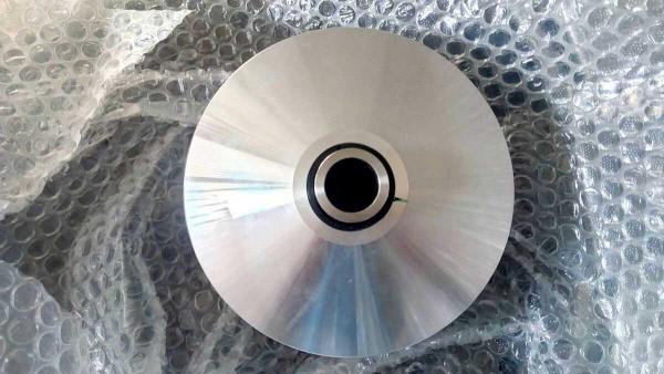

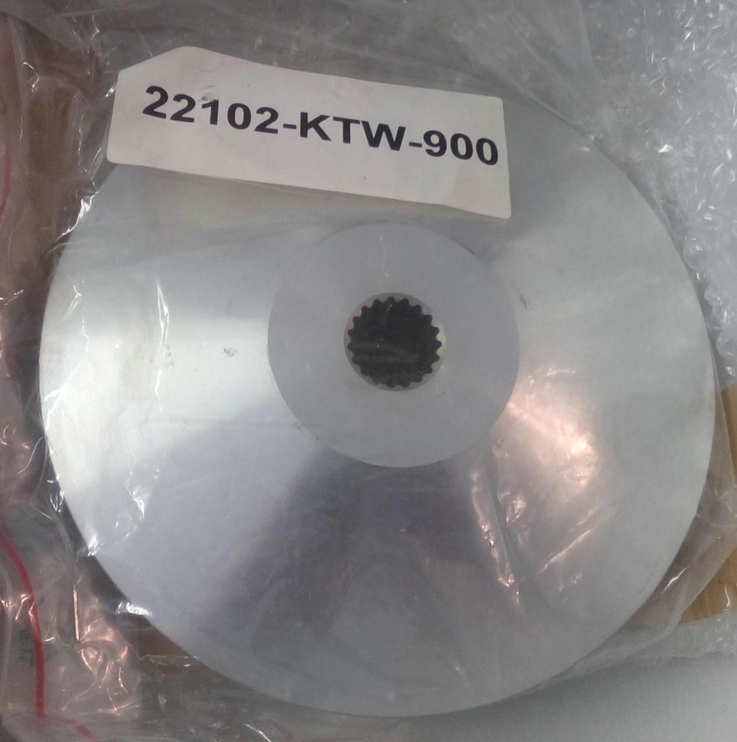

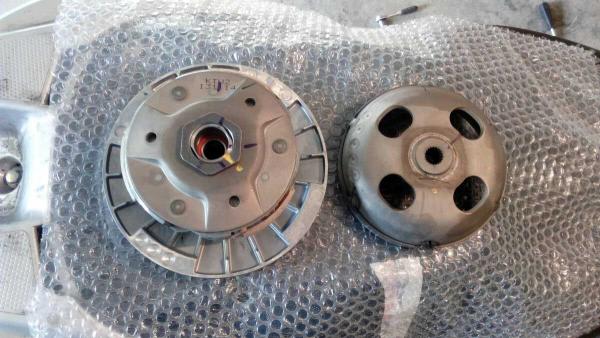

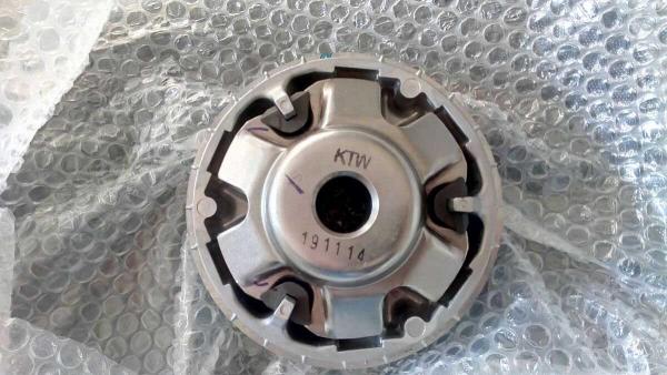

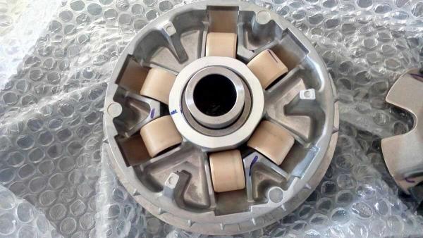

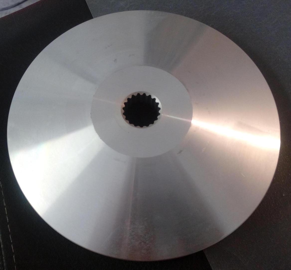

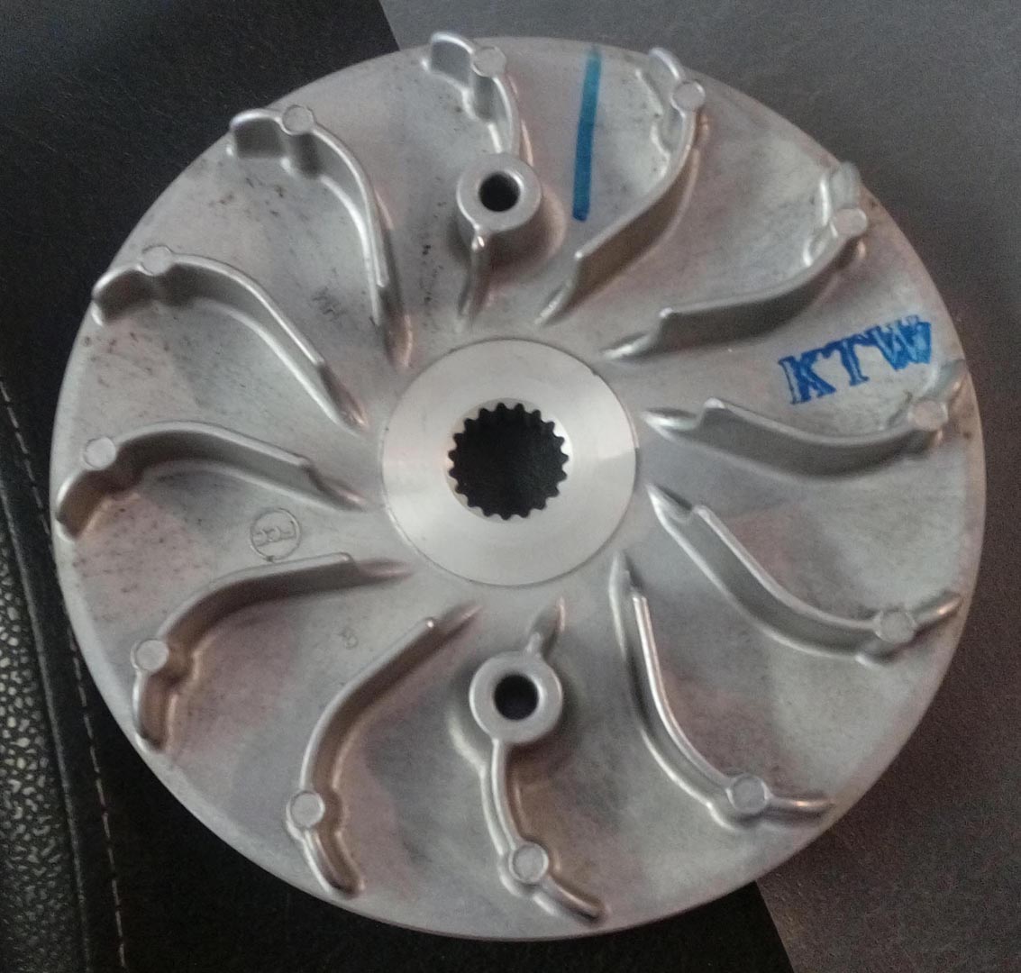

The bike had problems with variator and clutch so I bought brand new genuine variator + genuine belt Honda-Bando. Here are the parts I bought:
1) Movable drive, boss, ramp, sliders and rollers.
2) Drive face 22102-KTW-900.
3) Driven faces/torque driver + clutch.

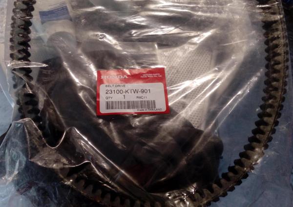

4) Belt Honda Bando 23100-KTW-901 (Thailand)
Here is the problem:

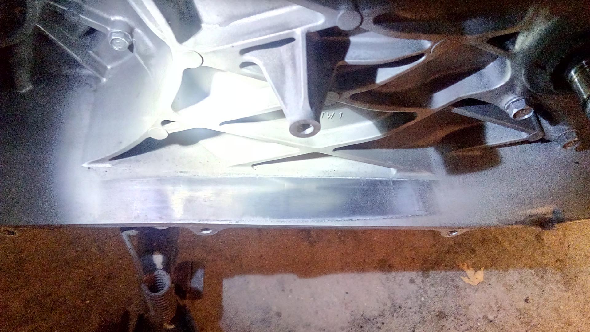

This is a photo before instalation of new variator + belt. The problem is that the new belt is also rubbing on case. I can hear it hitting the case during acceleration at low speed (10-15-20km/h), deceleration, constant speed 30-40, and sometimes in different conditions. So what can be the problem? Everything is stock. Why?

I'm thinking on another thing - is it possible the belt to be directional? Now it's installed with the label readable when you are in front of variator side.
