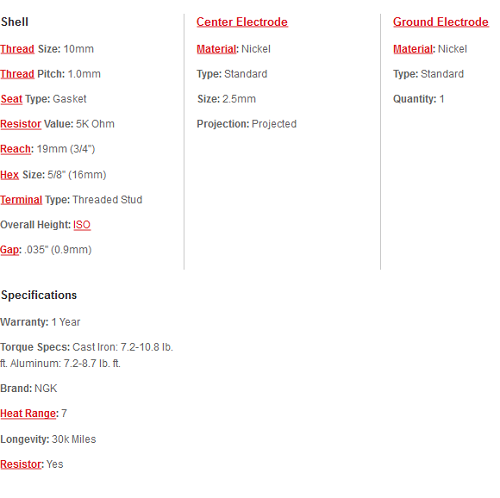

Posted: Tue Jan 01, 2019 10:48 pm
by springer1
Honda PCX is fitted with a standard copper core NGK spark plug
Interesting - I can’t find a spec on the specific pcx plug, but some other NGK “copper core” plug specs say 30k miles! I donno what to think.

Posted: Wed Jan 02, 2019 12:29 am
by raito
Standard spark plug for PCX 2017 and older:
https://www.ngk.com/product.aspx?zpid=9637
CPR7EA-9 $4 18 NGK 3901.png (58.74 KiB) Viewed 8357 times
For "Longevity: 50k Miles", use NGK 9198 CPR7EAIX-9 IX Iridium Plug.
For new PCX 2018, use MR8K-9 standard NGK plug. So new can't find the product page for it.
