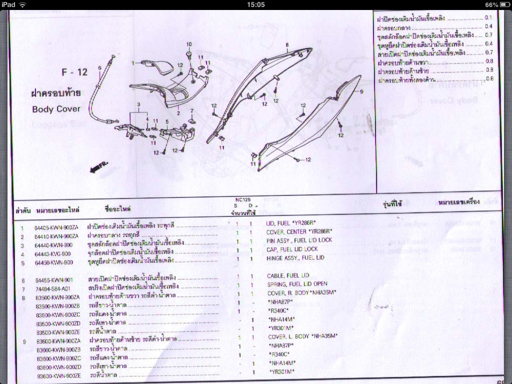

Hello all.
My new PCX 150 is a load of fun to ride. As I'm looking her over I realized that the side fenders along the
rear area have a plastic tab sticking down that seems to need a rivet or bolt or press in fastener
to attach the fender flair piece to this mating tab below that has a rubber component in it.
If someone could look on their PCX for me and determine if the fasteners were left out of mine I'd appreciate it.
I'm looking for an exploded view on the internet and it appears there is a bolt or something missing.

Yes it does. I found this also but can't tell if there are suppose to be screws, press ins or what attaching this.
Can you check your bike for me and reply?
Thanks
Ken

hey i just checked mine its a red 150 new from the dealership i have had it one week and its the same as your nothing in the holes on the right or the left

Same here. On my 1.5 year old 125 it has never had anything there. It helps you out when removing/installing the panel. Keeps things in place before you get everything else done.

on the non USA versions the stud screws onto the rear faired indicators. In the usa version you have different indicators out on stalks so that's why you have a screw hole doing nothing...

Sorry but I blame it on your US bureaucrats for wanting Honda to change the bike to meet USA requirements. (Indicators not far enough apart, engine kill switch needed, parking brake, disabling the Idle stop function). No holes on the ROTW (rest of the world) version ! And we have nice faired indicators and the best idle stop function of any bike or car. Though I would like the park brake...
