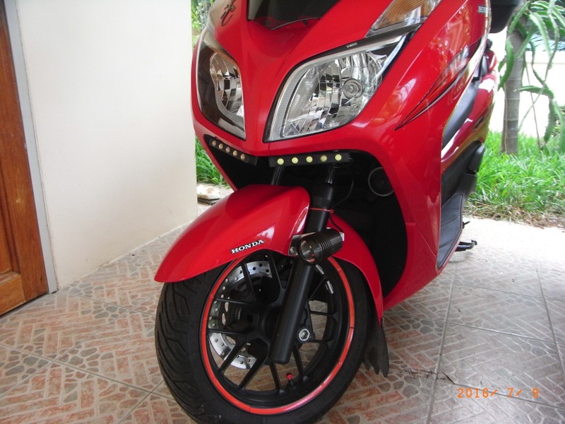

Re: Led Lights
Yes I have 2 spotligts 30w each it is very bright and I have change headligt bulbs to 55/60 w osram nightbreaker and even change cabels to the headligt the orginal is to weak so I have a very good light in the evening
- RIMG0832-800x800.JPG (121.97 KiB) Viewed 3322 times

Where did you get the extra front lights?
affeno
- Posts: 23
- Joined: Sat May 16, 2015 1:37 am
- Color: red
- Location: thailand
Re: Led Lights
I bought them from china aliexpress 10 usdollar each but it is long delivry time

Re: Led Lights
I bought this ones http://www.aliexpress.com/item/2014-New ... .84.cWpi9X it is a good light but when you turn it on you have high beam + low beam+ strobe that is no good but otherwise the lights are good if you want to have them on the forklegs you have to make your own attachment
