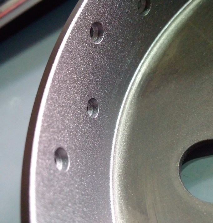

Screen Shot 2016-07-01 at 11.14.05.png (624.45 KiB) Viewed 4456 times
It's a common problem.
It's either a front variator problem. Change your rollers to lower weight.
Or change your clutch, like me in the picture. Makes the clutch engage much more smoothly.

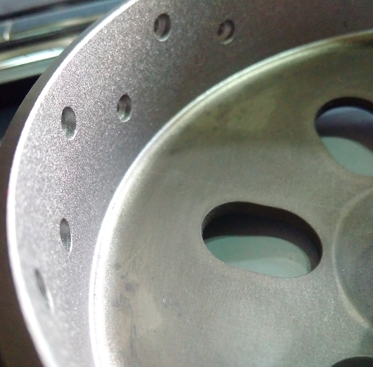

Screen Shot 2016-07-01 at 11.19.20.png (748.76 KiB) Viewed 4455 times
Clutch bell mod to make the clutch catchier, smoother and cooler running, think of brake disks with holes in them ;)
Screen Shot 2016-07-01 at 11.19.42.png (740.73 KiB) Viewed 4455 times
Nice heh?
