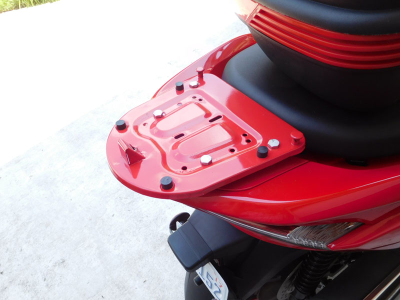

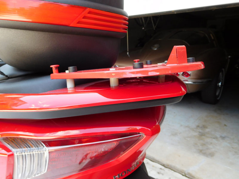

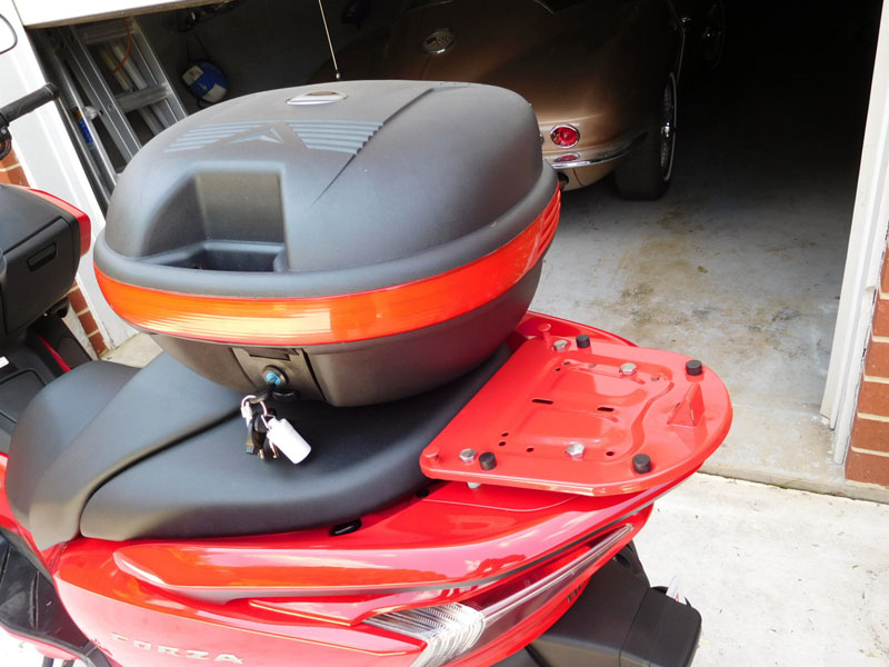

VERY inexpensive Trunk and mounting plate for Honda Forza.
Trunk (delivered to my door) cost me $30. Add in another $2 for spacers and all-in price is $32.
http://www.ebay.com/itm/181614525441
Optional: Add another $6 for stainless metric screws, $5 for red paint and total "all-in" price is $43.
I used the black metal mounting plate that came with the trunk. I painted it red.
I first removed the rear plastic panel....store away....dont need it anymore.
Then I carefully measured the threaded mounting holes that are already on the forza frame.
Then I drilled holes in the plate which are spaced as measured.
I purchased 1 inch high nylon spacers.
From same hardware store, I bought four stainless (to prevent rust) bolts of the correct size.
Once everything test-mounted, I painted to metal plate red and let it dry for two days.
Then I bolted up the new plate.
Done!

Thanks. The quality of the trunk is OK. The weakest link is the latching mechanism which locks the trunk to the plate. I expect if something breaks it will be that.montliz44 wrote:Well done, Pullin -- Strong contendah for the coveted PCX/Forza MacGyver award.

Have you ridden it with a passenger, doesn't look like too much room?

Its a squeeze with a passenger, but possible.
I forgot to mention that the trunk is fitted very close to the back seat.
The back seat will open fine with the trunk on, but the seat does touch the trunk when it is swung open.
In hindsight I would have drilled the plate holes to give 1/4" or 1/2" more space.

Your plate looks strong enough to take a few more holes. If it becomes a nuisance I think you could move it back 1/2 inch. No one would see the extra holes.

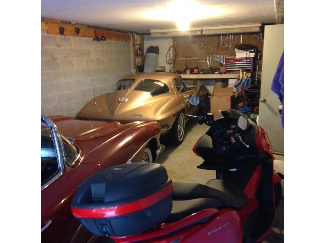

Re: VERY inexpensive Trunk and mounting plate for Honda For
is that a full size garage? WOW those 4Z's are HUGE!
Is that a Corvair in the garage?
63?
Picture & info please.
63?
1963 Corvette SWCfish wrote:Is that a Corvair in the garage?
63?
- IMG_0114.JPG (78.65 KiB) Viewed 9106 times

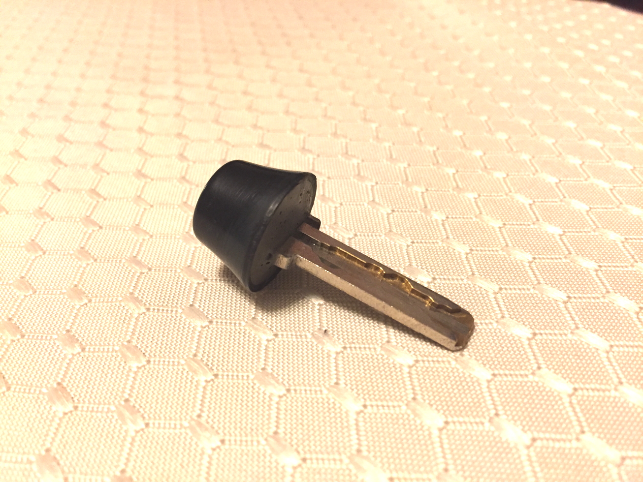

I took an old radio knob, cut one of the Givi keys, and epoxied the key into the knob. Now, I have a stealth key in there all the time. When parked, I turn the key just slightly to the right so that it can’t be pulled out but the lid button can’t be pressed.davenowherejones wrote:I do not like the key arrangement. It is possible to put the key inside the case and lock it inside. Not good.
Hold on... I’ll go take a couple of pictures. They’ll be harsh because the sun has already set here so I’ll have to use a flash.

Here’s the key-and-knob on the dining room table.
I had done a similar thing with the Goldwing. The gas hatch and side pocket had locks that took the bike’s key. I got extra keys, bought some extra radio knobs (so that they looked exactly like the other knobs on the "dashboard") and created permanently installed keys so that all I had to do was twist the knobs. In 152K miles, no one ever messed with them. They just looked like a natural part of the bike, and not at all like keyed latches.
