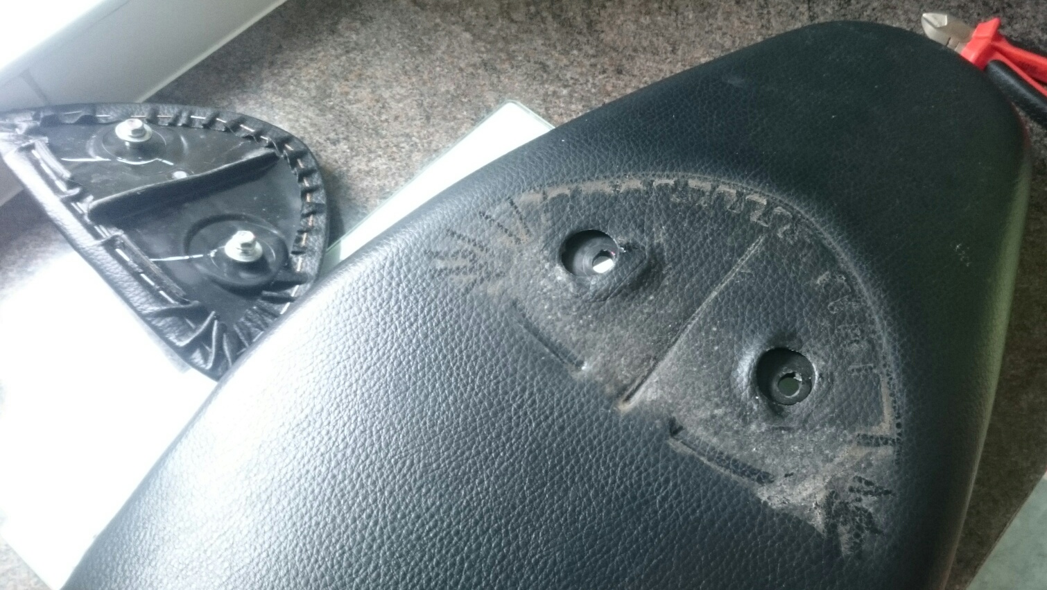

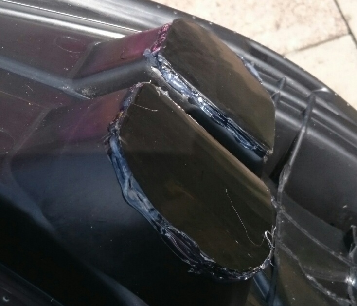

Re: Seat re-cover
Start of some thing beautiful
- IMG_20160529_232122.JPG (455.38 KiB) Viewed 4579 times

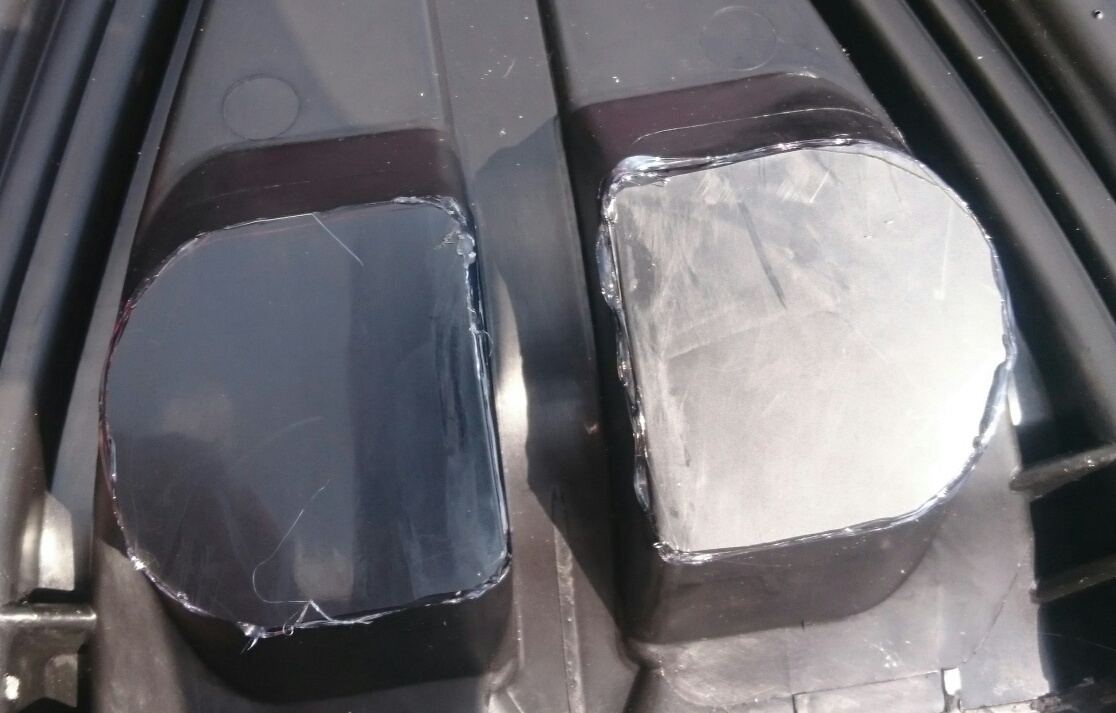

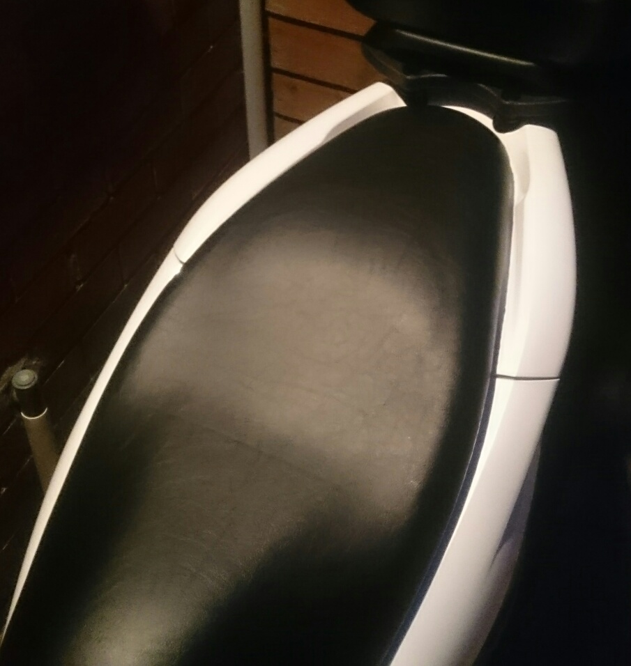

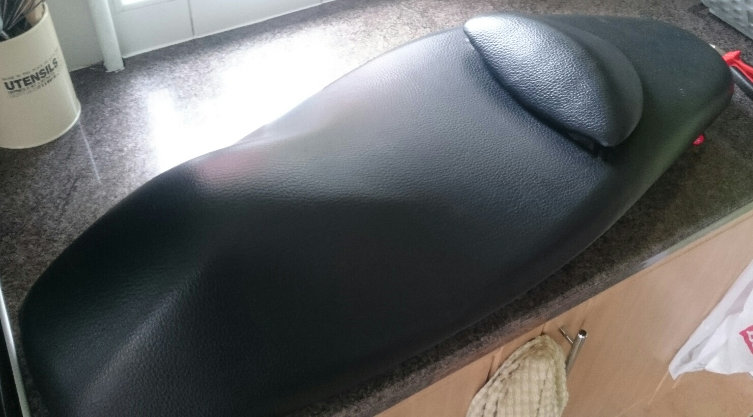

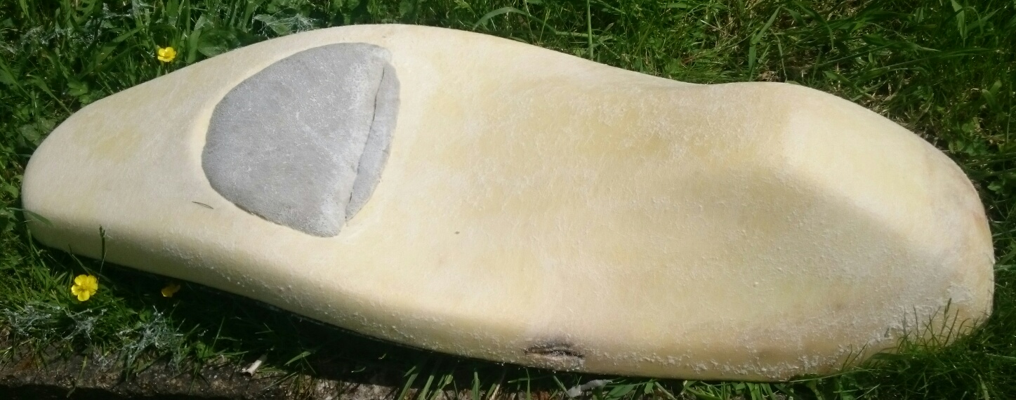

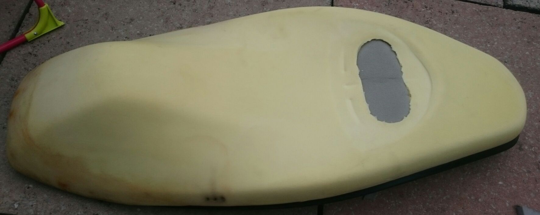

Re: Seat re-cover
Think I did wellfor my first time fabricating, pleased with the result

- Ishkabibble
- Posts: 278
- Location: Augusta, Ga
Re: Seat re-cover
That's some skill there.
I really admire people who can make those kinds of alterations. I don't have the courage to even attempt it, nor the skillset to see it through.

Re: Seat re-cover
Seriously thanks
Ive never done anything like this before, let alone have the skills to do it ihave a fast memory and you tube
also a side of me that cant resist tinkering, again thanks I thought it was an amatuer effort im pleased with it all the same
