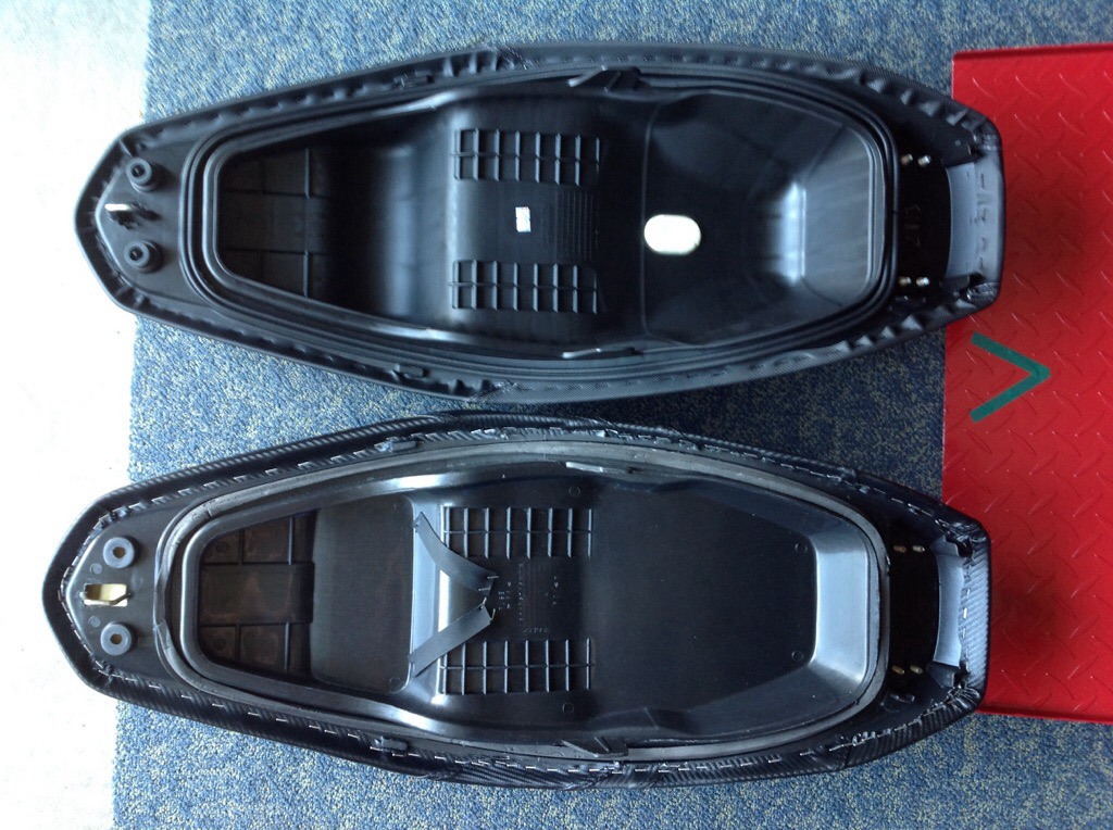

The other day I took my New #18 seat off. Holy smokes! What! Already?! Why?
Dave Bo who sold me the seat, was nice enough to include a new oem packaged under-seat weather seal. The seat came with a foam squishy type seal. See the bottom seat in the photo.
So off came the seat, off came the squishy seal and on went the Proper Weather Seal.
Well, that sounds easy right? It was basically but I'm a tad anal so cleaning the surface thouroughly prior to putting on the new was important to me. So After pulling off all the stringy type rubber cement I grabbed my bottle of isopropyl rubbing alcohol, a paper towel and cleaned the seal track out.
Heh! I want a Good Stick on the next fitting :P
The new seal comes a bit longer than needed, I'd say an inch or so. I liked that! It leaves room for error and for extra should your seat require it. Okok blah blah blah...
Both the old and new seal have a thin tape on the backside, a self stick n seal you could calls it. You must handle it carefully and remove the waxy cover backing as you go along applying it. You don't want it to stick in the wrong places o_O now...do you? No. So, take your time. The payoff is worth it.

......Alrighty I be back
I followed my own advice and the seal went on beautifully, no glitches. I trimmed an inch off at the end where the two met in the middle (at/near the rear latch). TahDah, Finis!
Ah Not so fast WhiteNoise, you forgot about those two seat bumpers! They're missing on yer new seat!
I see two empty holes staring at me! Oh yeah, okay I'll pull them off the old seat while I'm here ;) and re-use them. Cool!
I gave each bumper a slow twist and pull and out the holes they came. Yes, of course I was nervous. I didn't know what was on the other side of them bumpers (geez, can you see it? :lol: )
I didn't want to tear them. Okay we're past that Drama!
I got them both out without a blemish! Double TahDah!
Getting them into the New seat? You just had to ask right? No biggie but....
I did have to shape the holes that receive them (see pic above of New seat's holes).
Those two holes were "roughed in" and a wee bit too small of an opening (you Don't want them too big either, else the bumpers will swim in there :P ) So I got my round file and carefully filed bits off...little at a time till they looked a match to the OEM seats holes. Perfect, did it, I was happy. I cleaned the area and slowly pushed them in with a twist and Voila! Both bumpers were in and seated.
I grinned a proud grin, returned to the garaged where me scoot sits spoiled upon her lift and adorned her once again with a brandy New Saddle. She flashed her lights afterwards. Guess that means she's Ready To Roll! 8)
Well that's All Folks! Do not hesitate taking on the job of switching seats. It's A Fun to Do Mod and one that will make your arse and back sigh of R E L I E F
