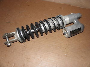

Recently bought a 2011 PCX 125 and have modified the air box and snorkle delete so far....stupid scooter only goes 57 mph top speed..
rear shocks are horrible on this ride...So....last night I bought a kawasaki KX65 rear shock..(SHOWA)..and just finished removing both stock shocks...(pogo sticks)..I am 195 lbs.....KX65 shock is now on the muffler side of scooter..piggyback reservoir hits plastic underseat "carriage"..
so i trimmed it a little....then went for a ride.....WOW....what a difference...stiff as hell, but glued to the ground and it swallows up bumps big time....now you see how bad the front suspension is when you fix the rear..!
this shock has the spring preload on the softest setting and compression setting is set also @ softest setting....
I think I could be the first to do this..? Shock cost me $ 20 on Craigs list... :P

this shock
this shock
my honda elite 80 had one one shock.....
then my honda ch150 elite had two....
"makeshift"....i guess...works quite well....just got back from another ride....
2---kx65 shocks would have no absorption capability.....WAY ROCK HARD...too strong.....ONE alone is Very strong....even @ softest setting.

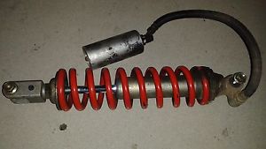

My last scooter was a 1987 CH150 honda..also had 2 horrible little shocks......I replaced those with Showa shocks from a SL350 Honda motorcycle...preload adjusters only (set on hardest setting)..those shocks were a decent improvement....
but nothing like this KX65 shock....I may remove it for a CR80 shock with remote reservoir, so I dont have to cut into plastic sub seat "carriage"...
