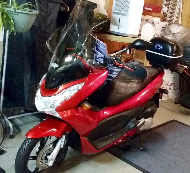

There have been multiple threads on this subject. The biggest question has been whether the charging system can handle some of the lights that are available. I wired mine through a switch that I put on my handlebars, and straight to the battery. I then put a large safety pin through the switch so that kids would not be temped to turn them on and run down the battery. Here is a picture of one of our bikes (we have two 2013 models).
Note the side lights beside the front wheel. They are LED, and made by KAWELL. I hope this is a little bit of help. You have to replace the side reflectors down there with long bolts with lots of locknuts. I did some additional things to mine, but that is the basic concept. I followed Maddiedog's lead on this one, like many others.
