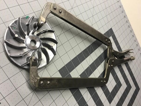

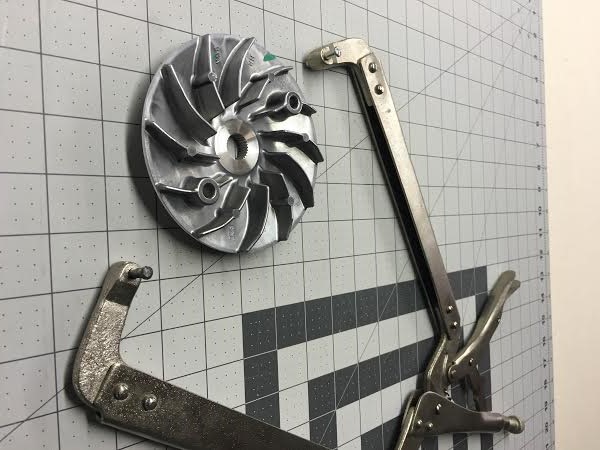

Honda OEM tool part# 07725-0030000 clutch center holder
Here is my homemade version yet to be tested under torque but looks promising. Much thanks to waspmike who suggests making your own.
