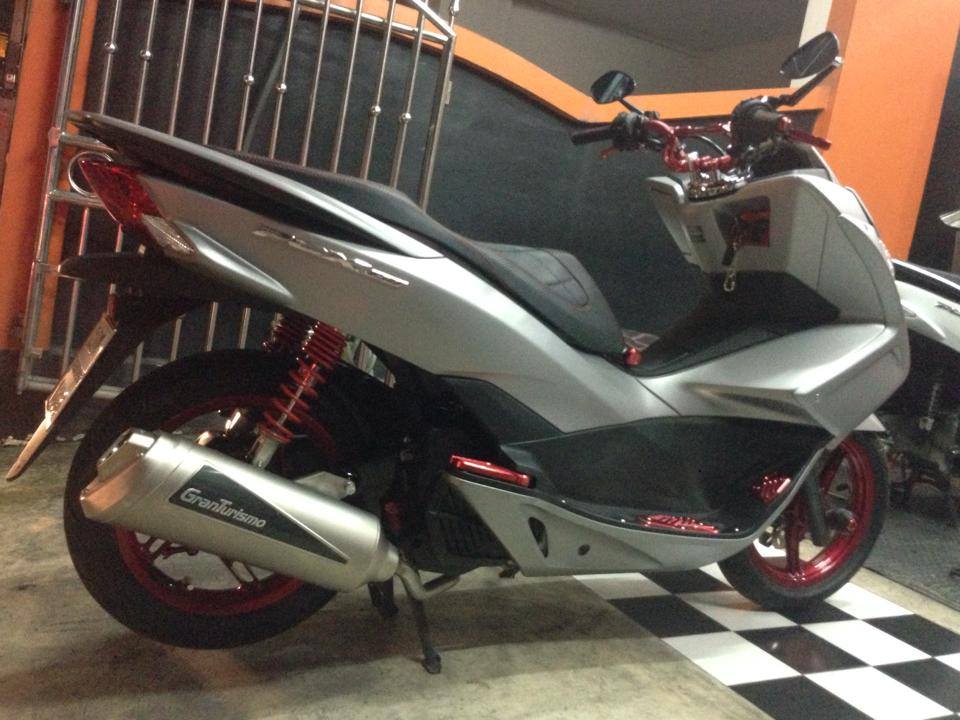

You can try the Leovince Granturismo, which looks awesome and very aggressive while keeping an elegant style. The sound is nothing to write home about, I've heard it in real life, not very bassy, which in my taste is a must for exhaust. Here's a picture:

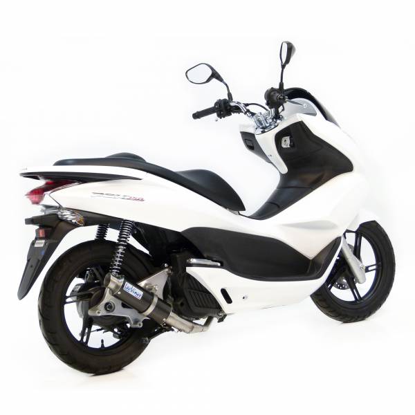

Or the Leovince Corsa, which cost a lot less than the Granturismo, it's a hanging exhaust, full system so it may shake a little. I used to have a hanging exhaust, the shaking alone drove me crazy and pushed me to sell it, hanging exhaust never again. The leovince Corsa has a lot more bass, which is great but the sound level (dB) is much more compared to the Granturismo, if it's not a hassle then it's a great value/price ratio product.

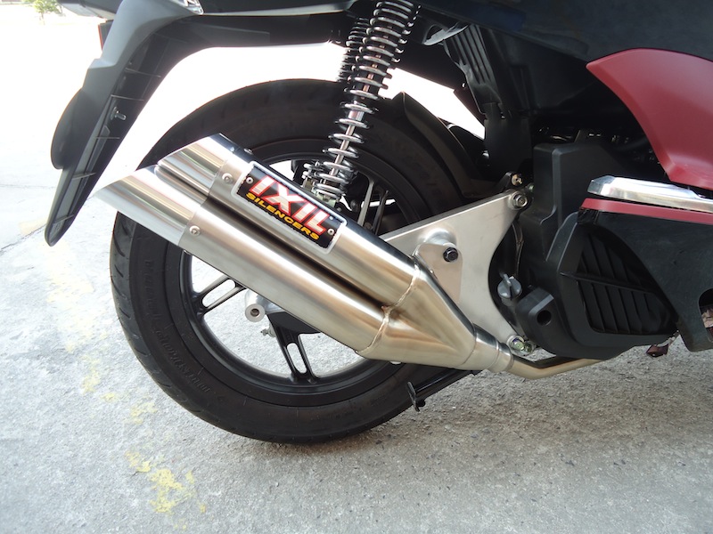

This is my personal favorite, the IXIL dual exhaust for the PCX. Gives you 4 options to choose from:
1/ 2 silencers installed, still has bass but a very low key profile
2/ silencer on top installed, bottom removed, more bass, but still low key profile
3/ silencer on top removed, bottom installed, even more bass, no more low key
4/ both silencers removed, the bass is insane, standing next to it can cause your heart to pump a little like standing next to a high power speaker. About the sound level, the police's gonna notice :lol: .
Plus it looks awesome.
That's a Youtube link of the 4th option, no silencer whatsoever. That's a real life video, that's me filming my friend's PCX 125 esp.
https://youtu.be/L1MpSQDvjtk
Hope it helps.

I do seem to be able to get the Leo Vince GP exhaust here in the states. Are you saying it rattles? Even if mounted properly?
I'm also curious because this system says 2012/2013 models, did they change at all between 2013 and 2015 or will this system bolt up fine?

It's a hanging exhaust. I've never seen it on a PCX in my country, but I've seen it on a lot of bikes and yes they do shake a little, even if it's a full system, but I guess it's fine because you can never have the tightness of metal like the Granturismo with a hanging exhaust. It does not shake like crazy, no, but shaking a little after some bumps or when the engine revving too high, yes, a little here meaning 0.04, 0.08 inch sideways, you would not notice it, the sound is not changed but the the guy riding behind you can.
My old hanging exhaust was a SBK EVO 2 carbon, shakes like hell, so I had to sell it because it drove me crazy.
I guess it'll fit just fine. Most exhaust are not info updated for the new scooters anyway.

I strongly recommend you DONT buy the Leo Vince gp corsa. I purchased it for my 125 as it looked awesome and was a good price. Fitted it no real problems. However, a number of problems once riding. The noise is just too much even with the db killer in. Secondly its completely straight through and felt quite a reduction in power. But the worst thing is that the header pipe swells before the silencer, when I attempted to turn right the exhaust caught badly and scraped the header pipe. I was practically having to go round corners almost upright. I managed to send it back, but it has major flaws for the little pcx. The malossi is a class act or get on webike, with loads to choose from.

You have to look for the exhaust where it shows the header Pipe is tucked right under the the radiator as much as it can be, only then you will have little trouble banking right..

The Corsa GP was designed to be a slip on with multiple pipe for many bikes.

How do you remove the silencer on the ixil?
