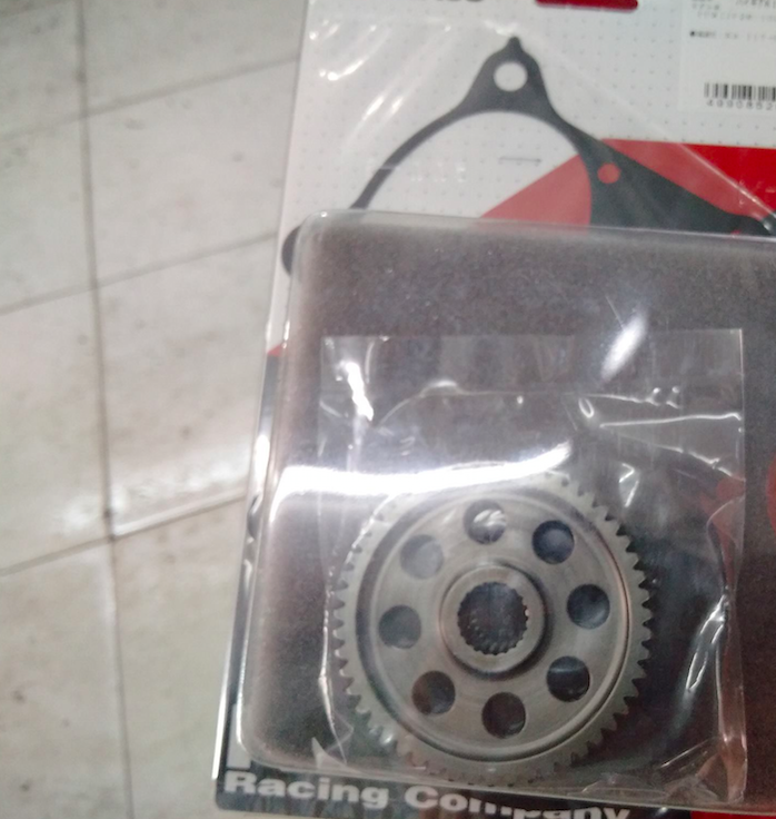

One bummer today though. If you're thinking about getting the Kitaco 51 tooth gear, think long and hard about my friend's experience.
He installed it in his PCX esp 125. which changed the gearing from 53 to 51, final drive ratio down from 10.55 to 10.15 to gain more top speed and to smooth out the engine a little bit.
However, the kit seems to not fit his other gears. Had 20km on it and it kinda howls, more and more, so I sincerely advise you guys to think again if you have an esp gear set, be careful, 55$ down the drain is a pain in the a**. I don't know why but I thought Kitaco would have thought about this if they make that 51 tooth gear to match a 17 tooth counter gear, not really sure. He had to remove the gear tomorrow and switch back to stock gears with the potential damage to his other gears.
So, be careful and think about my friend's experience.
Here's the gear. Must be some oddity but I think this should be an example of Murphy's law, something that can go wrong, will go wrong.
Cheers.

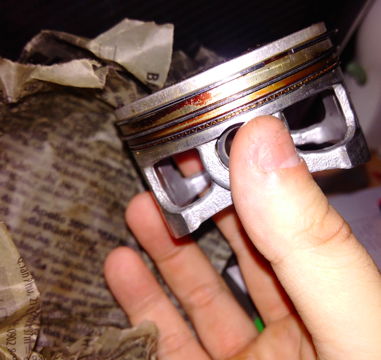

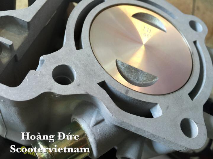

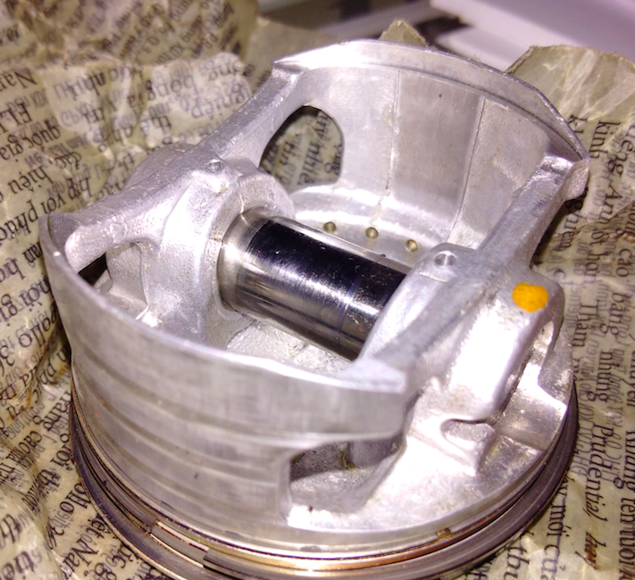

I had to take the piston out and show it off a little.
It's a Yuminashi 60mm piston. It's not a forged piston, at least not according to Yuminashi since they did not mention it.
Screen Shot 2015-12-06 at 0.02.54.png (779.31 KiB) Viewed 6774 times
Screen Shot 2015-12-06 at 0.03.10.png (894.93 KiB) Viewed 6774 times
The piston is very light though, and you want as light a piston as possible, to not waste the work needed to push it down. I currently have a Sonic 58mm piston and it weights more than this one so big plus for Yuminashi there, if it's a forged piston then it can be even lighter and even more reliable especially for such a high compression ratio (12.8 according to Yuminashi). You can clearly see there's carbon deposit on the top of the piston, no worries. This kit has 6000km on it so I don't need to change the rings, would be better but I'd rather spend my money elsewhere.

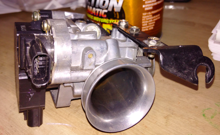

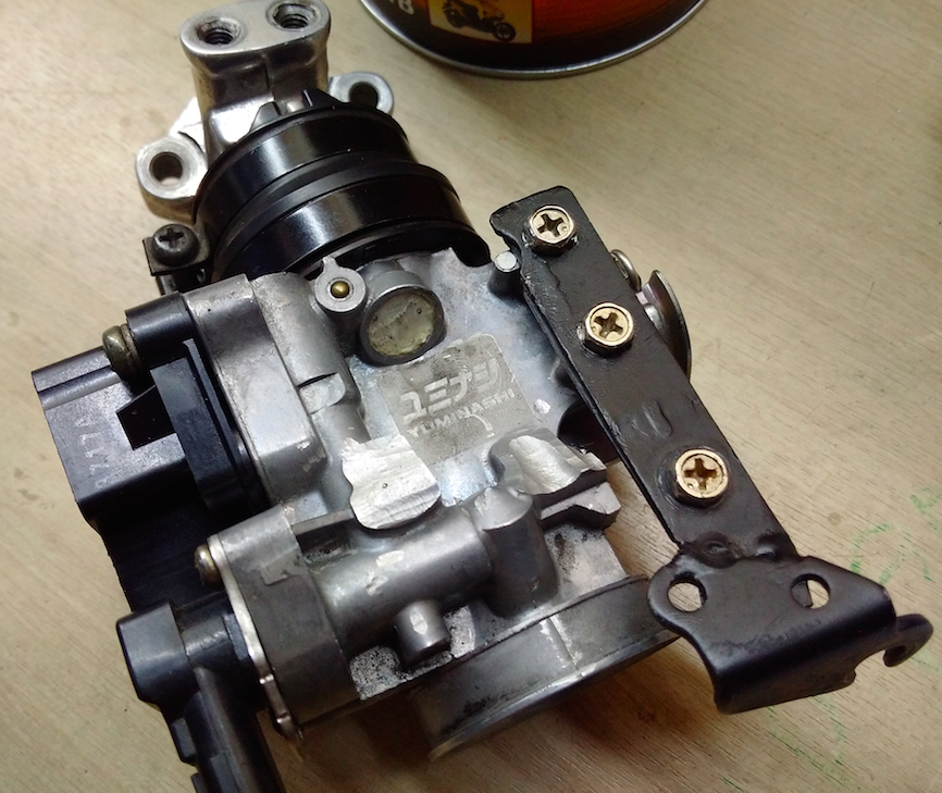

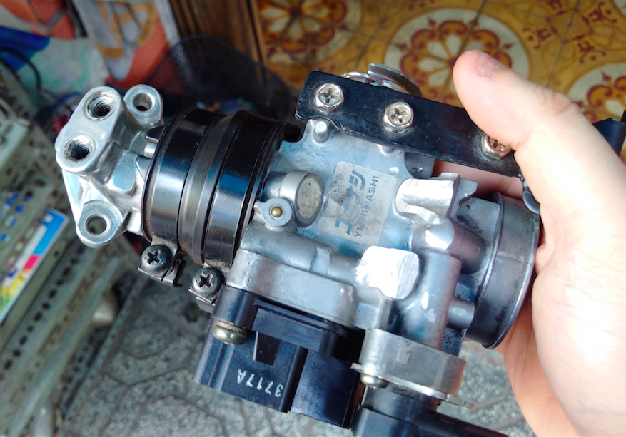

This is a closer look at the throttle body and manifold. I'm 95% sure it's a CBR150 throttle body which was mirror shine polished by Yuminashi. The guy I bought it from has modified it a little to make it fit his PCX 1st gen and from the outside it looks a little dirty so I got it for crazy cheap, throttle body and manifold about 70$, that's his asking price. I was shocked :lol: since it works just fine. To put it on my scoot it will require a wire loom, but I already ordered it, so more pics on the way.
Screen Shot 2015-12-06 at 0.04.40.png (694.88 KiB) Viewed 6774 times
Screen Shot 2015-12-06 at 0.04.17.png (941.23 KiB) Viewed 6774 times

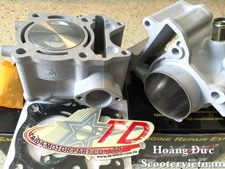

If you want to have a forged piston then there's a 61mm (170cc) kit from Taida in Taiwan which is very well made and pretty cheap, with a ceramic plated cylinder wall and a forged piston (at least according to Taida), they make big bore engine parts for GY6 engines and are quite popular. I have observed a kit up close but did not have the chance to take pics.

I like the throttle cable mod. What's a total length up to the weld and Also what the third screw for?
Re: Project V27-164
Posted: Sat Dec 05, 2015 7:19 pm
by BPT7594
I'll measure it when I got home. I'm not really sure why he had to modify his throttle cable. I'll ask his mechanic (who happens to be mine too) about this.
He did have to shave a bit of metal on the top of the throttle body. Because originally it's for the manifold of the CBR150 and the fuel injector. The pcx v1 has a metal thingy that touches the throttle body so he had to shave it off.

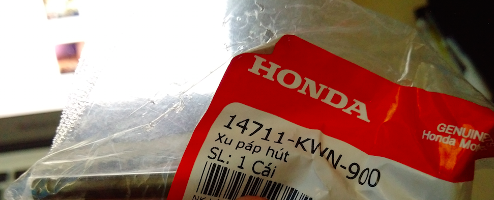

Got some goodies today. Both from Honda and Yuminashi.
1/ Stock cylinder head.
Screen Shot 2015-12-09 at 15.40.03.png (463.71 KiB) Viewed 6705 times

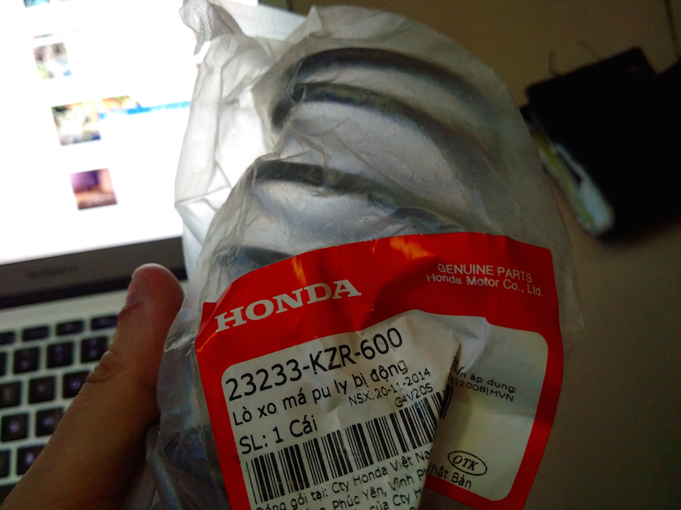

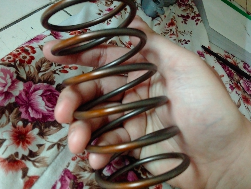

3/ Stock torque spring, as recommended by Reggy to go with the Torque Control Variator
Screen Shot 2015-12-09 at 15.37.49.png (927.69 KiB) Viewed 6705 times
Screen Shot 2015-12-09 at 15.55.03.png (1.07 MiB) Viewed 6705 times

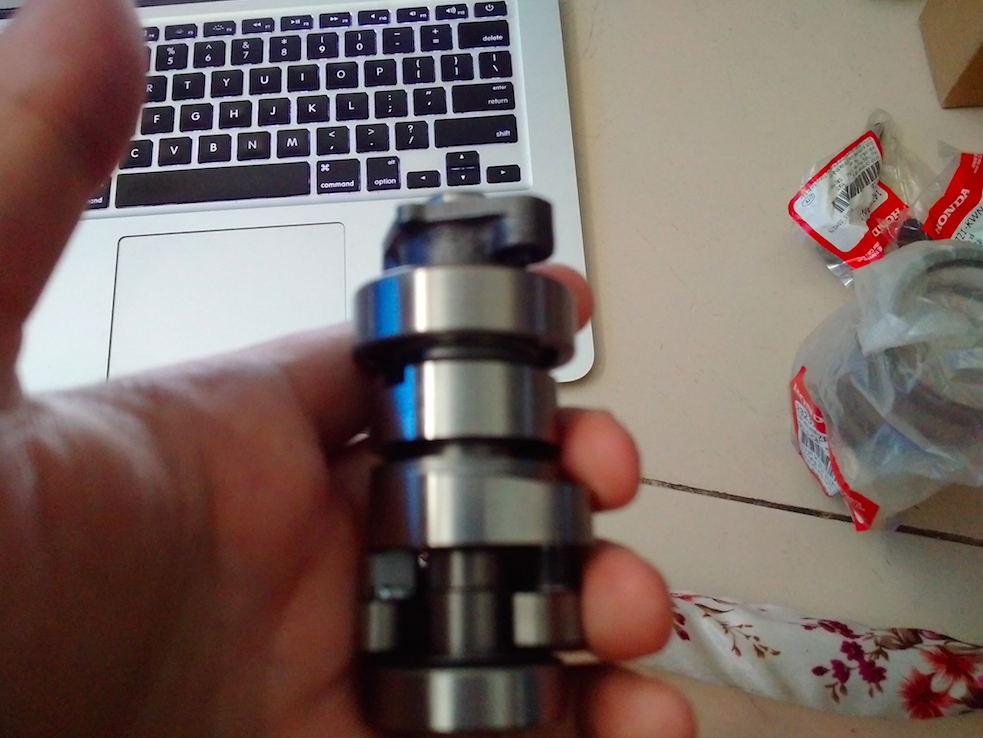

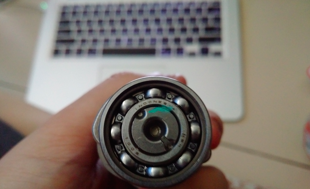

4/ Stock cam, I'm waiting for my replacement camshaft from Yuminashi.
Screen Shot 2015-12-09 at 15.54.20.png (884.17 KiB) Viewed 6705 times
Screen Shot 2015-12-09 at 15.54.35.png (760.83 KiB) Viewed 6705 times
Screen Shot 2015-12-09 at 15.54.47.png (997.47 KiB) Viewed 6705 times

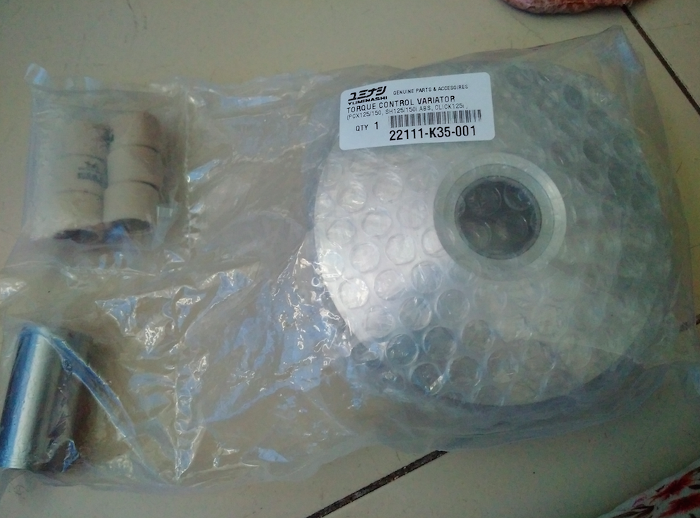

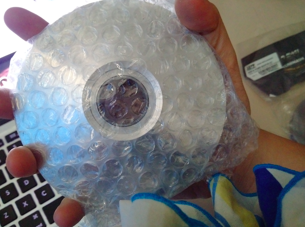

5/ The Yuminashi Torque Control Variator, comes with 1mm shorter stock pulley boss, 10gram rollers.
Screen Shot 2015-12-09 at 16.07.27.png (1021.88 KiB) Viewed 6705 times
Screen Shot 2015-12-09 at 16.08.07.png (844.88 KiB) Viewed 6705 times
Screen Shot 2015-12-09 at 15.55.14.png (969.58 KiB) Viewed 6705 times

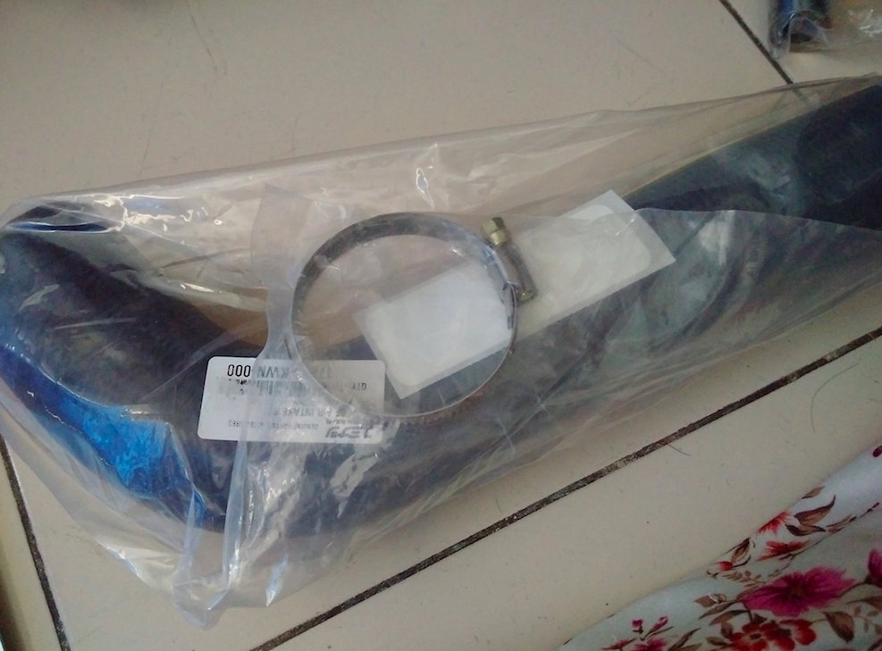

6/ Big tube air intake, I figure I'll just get it from Yuminashi anyway.
Screen Shot 2015-12-09 at 15.57.28.png (956.92 KiB) Viewed 6705 times

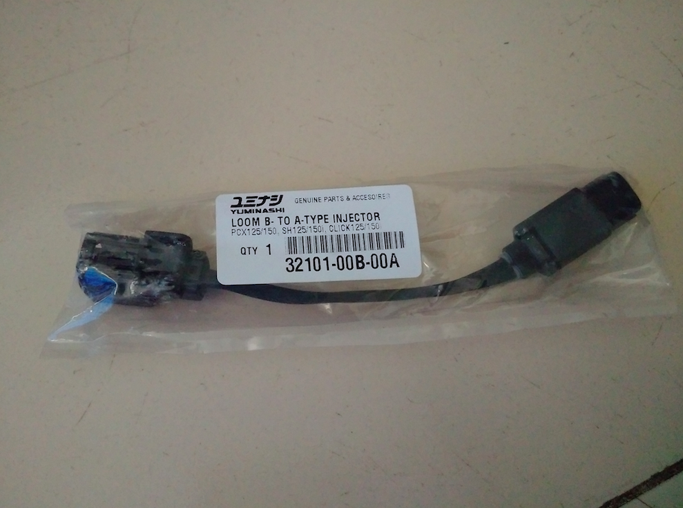

7/ B type to A type wire loom, again, easier to just buy from Yuminashi
Screen Shot 2015-12-09 at 15.57.41.png (873.24 KiB) Viewed 6705 times

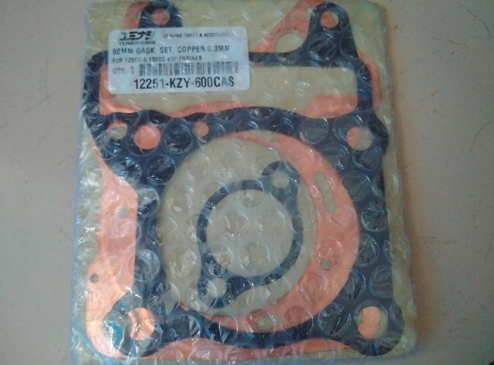

9/ Gasket set with the 0.3mm thin copper head gasket from Yuminashi

I did tried the Yuminashi variator. 10 grams were too light, so I dropped in my 12 gram rollers. The 1mm shorter boss does not fit my driving style too so I dropped it and use the stock boss. Perfect. I have to say my scooter has too much torque now, wheelie on the throttle control is possible, I did lift my front wheel a little but since I destroyed my valve springs I dare not WOT anymore.
The surface of the yuminashi variator is not as shiny as their old Speed Control one. It does not have separate ramps with different angles either, or at least I think so. The surface inside is weird though. It's rough. I think they do this to keep the rollers from going out too fast, but with this kind of rough surface I don't expect my rollers to last too long though. But I can change my roller every 2000km or so, rollers are cheap here anyway :lol: .
One thing I do worry about is my belt. I did not get the Gates belt, I use my stock one which has 8000km on it. With the extra squeezing and everything I really hope it's okay. When I have enough stuff to rebuild my engine I'll take it out to check, I have a new stock belt sitting in my garage, maybe I'll be careful and install it then.
The only problem I have with this variator is perhaps the inertia booster itself. Too much torque results in some dropped acceleration, but the scooter is very smooth, RPM changed fast but gradually, not suddenly. I hope I can machine the inertia booster a little though, because without it the scooter lacks some punch, with it, acceleration can drop a little. Maybe 350 or 300 grams will be enough, but I'll restrain from doing that until I rebuild my engine.
The feeling I have with this torque control is very good. There is torque at all RPM, I must say that, and a lot of it. Whenever you twist the throttle, there's more torque, but I did not check this above 80km/h though, no road to test and the valve spring thing. So this will be updated.

Update with the variator.
I did a test run. Turns out 12gram was too heavy and the engine runs into overdrive too soon with the stock torque spring.
I drop in a new pcx v1 belt as recommended by reggy and my mechanic. The take off is somehow weaker but obvious increased acceleration. 10 gamr is now the way to go.
There's some rpm range that the engine kinda vibrates a little under 20km/h. Think it's clutch slippage but not too sure
