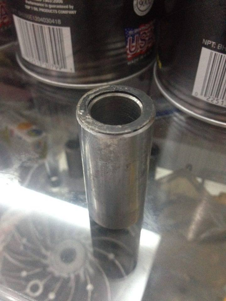

For better take-off, and I'm talking from experience here, you can add a 1mm or 0.5mm washer in the pulley boss to go with 16g rollers on full stock vario and clutch etc.. My experience with stock clutch is terrible as it makes my pcx's head shake too much at low speed.
Like this
Like this

Or you can add the washers like my picture above and buy 14 or 12g rollers.
