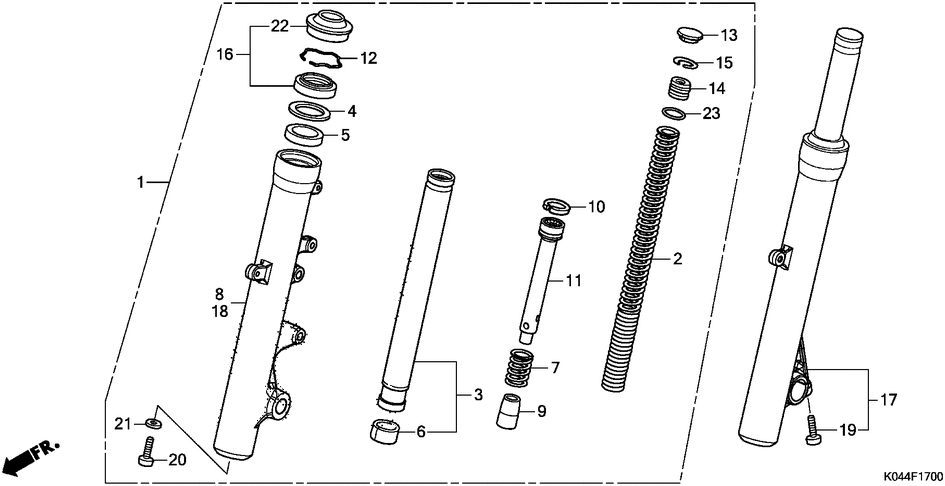

Addition please find a picture from the forza parts manual to see the items involved:
- itm. 13 plastic cap to remove first
- 14 spacer to be pushed down
- 15 circlip to be removed
forza front fork.gif (46.47 KiB) Viewed 11135 times
Hope it helps.

How come the spacer comes out by pressing it? Do i need to press only the spacer or by pressing the inner pipe? Thanks
Re: Front fork
Posted: Thu Nov 12, 2015 12:40 pm
by Oyabun
The assembly is held together by the force of the main spring pushing the spacer to the circlip, what is herefore locked into a groove inside the tube. By pushing down the spacer inside the tube (without pushing the tube itself) one essentially releases the tension on the circlip, which can be removed and the whole assembly can be freed up. It is a lot difficult to describe than actually doing.
