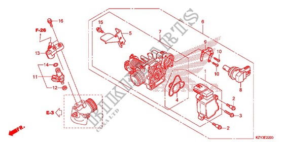

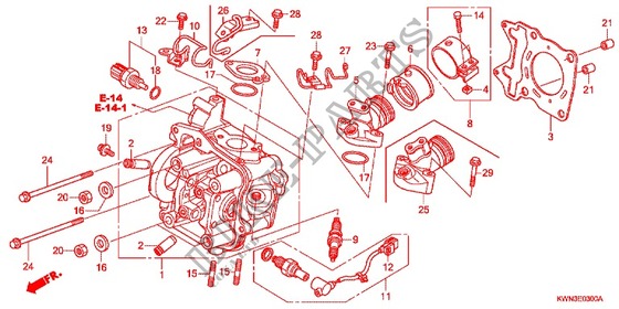

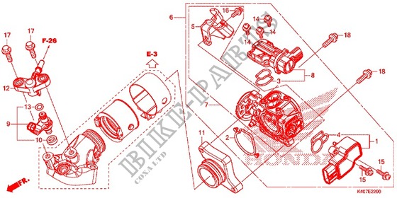

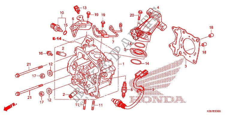

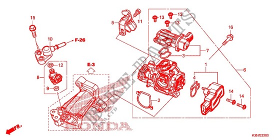

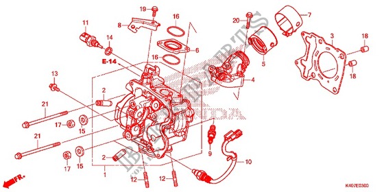

We might see different microfiches then as I pretty much see the same location for all sensors (not that it would make a huge difference to revire them anyway if controls line up)
The forza uses an interesting mix of components from the all new and older ESP PCX.
Here is 2015 the cylinder head assy of a forza 125
Compared to the 2015 PCX head
and the 2012 PCX head
And the same for the Throttle bodies
Forza
2015 all new pcx
and the 2012 esp
I'd definitely stay with the PCX ecu at first and use whatever sensors are available with the existing ecu.
