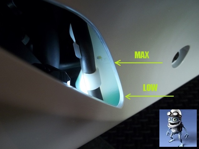

For those of us who do our own maintenance this is what you might expect at the 3k mile mark on PCX. Be diligent and have a look now and then especially if you're rolling over 3000 miles. Tuck your flash light up from under to get a good look and lets RIDE!

Is that reading on a cold motor? Also, how many miles are you going to see the oil go from the high mark to the low mark?

j.d.b... yes that's a cold coolant reading in the picture (be happy to warm it up) and I cant say for sure how many miles it took to go low on the oil stick but it was close to 1k because I started this riding season with 2000 miles and a fresh oil change. So yes check your oil level every 1000 miles for sure.

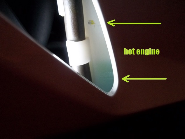

I like the hot level a little more
- coolant hot.jpg (115.3 KiB) Viewed 7309 times

homie, I think Tom192 is asking why is it using coolant? When I had a problem with low coolant on my PCX 150 it was because the water jacket above the intake valve had a hole in it.

Um... Tom I smell nothing and see no leaks, I assumed coolant has an evaporation rate and that it would be low at some point consistent with use.

Coolant levels always go down on any new vehicle because the hoses stretch out a little over time.

Just checked the coolant level for the 1st time (had the dealer do the 600 mile service). Just on about 5300 miles now. I'm worried now as I shone a torch like Homie suggested and I can see no indication of there being any coolant in that little chamber at all! (no liquid level visible in any of the pipe/chamber). The bike is on the center stand. I may get someone to help later by moving the bike side to side while I take a look at the pipe.

Just checked with two of us (bike cold). With a torch shining from underneath it looked like there was a light green coating on the inside walls, but when tilting the bike from side to side (and to the left) we could see some in there but about a cm below the low!!!!
Will look into getting coolant (proper one) asap. Worried how it can get so low if it's not supposed to leak!

That will probably only take a few cc's to bring it up to the line. If you are really worried you can open the actual radiator cap but I'm sure you will find it is completely full.iceman wrote: Worried how it can get so low if it's not supposed to leak!

Thanks sendler. I just phoned a dealer nearer to where I live (North London) and they sell it for £8 litre which is quite good. They said it's an easy DIY job - I'll have to check the owners/service manual when I get home. I did mention it's well below the low level in the container Homie showed above (bottom of bike) and they said that's just the over-flow chamber and not what is live in the system and everything should be fine - really - to get that low?
Actually, I'm confused now. Mine is the '15 led model which should be similar to the 150cc Homie posted above, and indeed the vessek checked is under the bike on the RHS. However I'm looking at a PDF of the owners manual and that suggests the place to check is behind the fuse box under the seat - so, has it changed or are these two checks totally different things? What is the 'below the low' level thing under the bike then?

So, having got home and had access to the proper owners manual the fill and check point had moved compared to the pre-led models - under the rhs floorboard and no longer near or behind the fuse box. Quite a few other changes then with the '15 models.

Bad news - just tried filling it up (as it was below the low) and soon as the coolant goes in it comes our the bottom
- not sure what is wrong - something loose, pipe/container got a leak. It seems to come out very near where the reservoir bottle is. I'm taking it to a dealer next Monday to check it out as I do not have the panel removal tools and I would not have parts if it needs any - they say they would have to order bits in if needed.
I'm hoping it's just a loose connection or the drain plug left of by the dealer when I had the 600 mile service
- not likely. Damn, no idea how long it's been like this and I only checked due to Homie mentioning his was low and needed a top-up - thanks homie!
It's probably been like this for ages as I've not seen a pool of liquid on the floor at home or work (only when I did the oil change and not tighten the drain plug enough) - wonder if it has been like that for almost a year! The high-temp light has never come on though.
