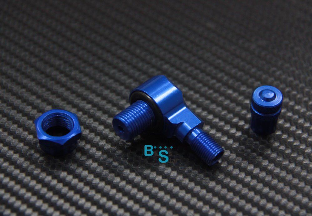

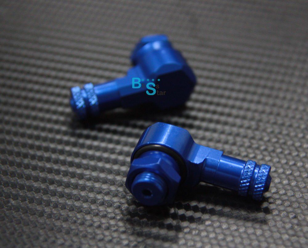

Hi,
Keep the original valve is a good idea (TR412 ??).
I added some external TPMS (tire pressure monitor system), and the rear one touched something, probably the caliper, so there are not to much gap.
May be you can install a very low profile valve stem like the attached ones.
Check also the the valve 65252-68 Motorcycle Bet, in Schrader catalog.
https://www.schraderinternational.com/~ ... 70113.ashx
Cheers
Blue Racing Motorcycle CNC Aluminum Wheels Valve Stems Caps 90 Degrees
valve 90 B.JPG (87.81 KiB) Viewed 3553 times
valve 90 A.JPG (90.32 KiB) Viewed 3553 times
