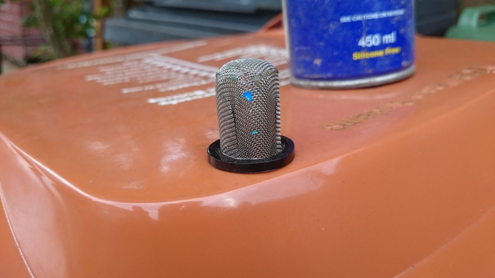

pulled the oil out and it was black as tar.
some weird bits on the oil filter as well looked like blue paint (no it's not off the WD40 :) ) and also fine filaments like steel wool.
sort sort of instant gasket residue?
good to go but still gonna check the fuel filter as well, def a job for tomorrow

The oil was black with a brand new scoot?

Blazinby wrote:still gonna check the fuel filter as well, def a job for tomorrow
The fuel filter is not a service item and is not available as a separate part, it is incorporated in the fuel pump, lives inside the tank, and should last the life of the scooter without ever seeing the light of day.

Yeesh...that oil is indeed very dark. Odd that is.

So, this PCX was sold as basically new with 1 mile on the clock, yet has oil looking like it's been in for 5000 miles or more! (and you have other concerns). Something not right here.
