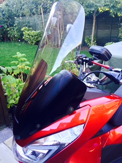

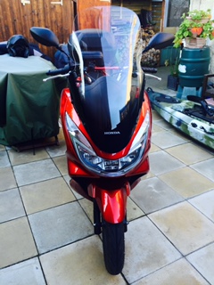

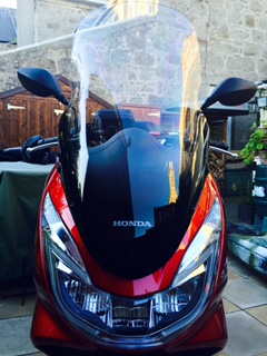

Ok, I got the fitting correct using the correct bolts, washers and nuts after a number of attempts. Although what I didn't do was move the mirrors. I have the mirror brackets and to be honest, had not idea what they were for......What is the reason for moving the mirrors???
I took her out for a 40 mile blast, the buffeting on the body has all but disappeared and I've got about about another 4 to 5 mph on the top end but the noise around the crash helmet has increased. I don't know if its because its quite a breezy day but I feel that the bike seems to be feeling the cross winds a lot more with the new screen on.

Aberdeen Scoot wrote:Cheers White Noise......Very interesting indeed.
Do the mirrors hit the screen on full lock?
Re: Fitting the 08R70-K35-D00 Wind Shield
.....or the brake levers?
Aberdeen where are ya? Any more opinions on the screen? Are your mirrors or brake levers hitting the screen when you turn the handlebar full left or right? That might be a concern. What say ye? Also whilst riding, are your eyes just above the screen or are you looking through it? Come back please
