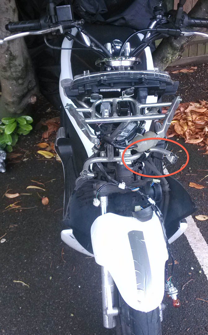

I assume I'd need some sort of welding skill? I tried to see if I could just bend it back into shape with brute strength, but I felt a bit silly for even trying!
Sadly, I have never welded in my life, and have absolutely no access to any welding tools.
I've attached a picture where I've circled the part of the frame that appears to be bent, in case that has any impact on the course of action I'd have to take...
Thanks again!

Yeah that sure is bent. I think cutting the bent piece off and re welding it in a stockish position would be the easiest.
but try bending it with a large prybar and or take the frame off and hammer it back into submission.
probably will take a long time to get just right... but definitely doable.

Aaah-ha! Hammer! Forgot about using a hammer. Will it really bend that easily, though? Looks pretty tough, to me! I'll give it a go, but if it doesn't work out, I've got a replacement spider on the way, so I'll just need to have lots patience and time!dasshreddar wrote:hammer
Thanks for your advice
