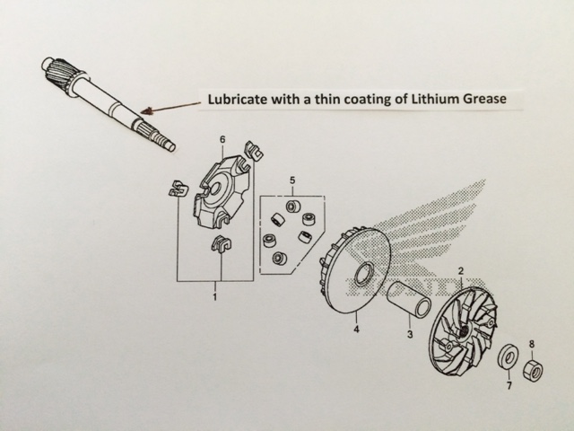

A picture is worth a thousand words... The tolerance in between the shaft and the inside of the boss (part #3) is probably around .001". If corrosion forms on either the shaft or the surface inside boss, you will experience the same "oh crap" moment that I did...

Relieved... I thought you meant something was sticking on the outside of the boss. I recall the inside was well greased, you could feel it when you put it back on.
