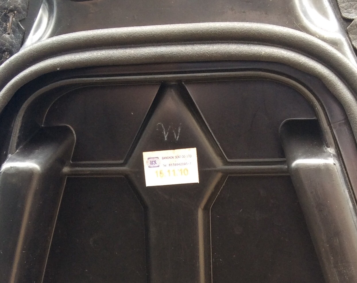

Can I ask where you got your seat from? I have bought from from bikerzbits in Thailand. It arrived today and is unusable as there is no rubber seal underneath like on the original so it will let water in. I've posted a thread about it.

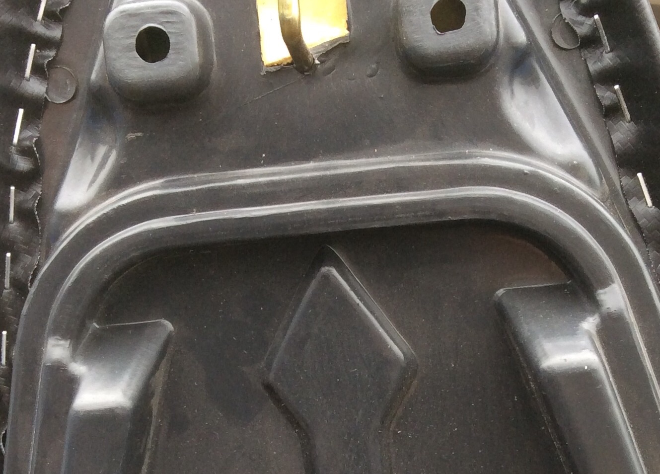

The original seat has a gap all the way around which holds in the stick on rubber seal. The custom seat has no gap for it to go into.

Ive attached photos

Re: Seat customization
The seal actually goes on that lower ledge all the way around. Start where the seat connects to the hinge and take your time. Pull the one from the original and use it.

Mel46 wrote:The seal actually goes on that lower ledge all the way around. Start where the seat connects to the hinge and take your time. Pull the one from the original and use it.
I'm not sure how that will work as there won't be anything surrounding the seal. On the original seat there is about a 1cm deep gap all the way around which the seal fits nicely into, holding it in place. If I just stuck it on the new one there would be nothing surrounding it so I can't see how the stickyness alone will keep it in place with nothing surrounding it??
It works, believe me. I added a picture to one of the threads showing my new seat. I took the seal off of my original seat and applied it to the new one. It still is there. Works well.
