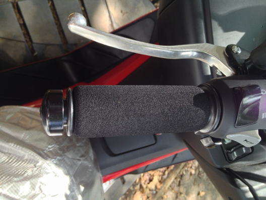

My hands prefer larger grips. Here's my current solution:
http://smile.amazon.com/gp/product/B00230P2E4
Grab On Grips Grip Cover - Fits From 1.25in. to 1.45in. OD - 4.25in.L, Color: Black MC401
I squirted a little isopropyl alcohol into them, and they slipped right on. Once the alcohol evaporated off, the things have stuck like glue, and now my hands are happier.
Here's a picture of one side (the other fits just as well):

Very nice, ordered, I like a larger grip too....

my last bike i used GRIP PUPPIES , same thing . an very good makes the grip fill the hand better.
