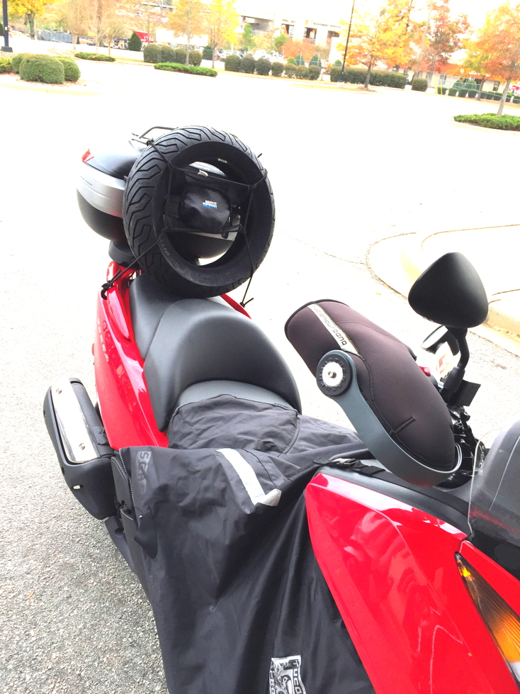

Well, I have the solution that seems to work for me. I have moved from a cargo web to a Chase Harper Bungee Buddy and have carried loads on the pillion both by hooking the lower hooks to the passenger grab rail and by pulling the lower hooks back & under the top box and hooking them to the posts under the mounting plate.

And here it is delivering a new tire to be installed at the shop. (The local Honda shop said that the rear tire I wanted was on backorder and gave me a date to try again. Before that date arrived, the tire did from a different source. I honestly do try to shop local, but they don't make it easy.)
So far, I am quite happy with this particular set-up for strapping items to the pillion. I'm only sorry that I didn't think to take a picture of the huge take-n-bake pizza I brought home a couple of weeks ago, because if I ever need to do that again, I'll spend far too long scratching my head trying to remember what I did the first time.

I have to do a similar thing for my next tire. I have a similar case and I want to get that tie down rack on the top. What are those hand guards/mits? Where?
Re: Forward attachment points for pillion cargo?
Posted: Sat Dec 03, 2016 9:04 pm
by MBMyer
The handlebar muffs are from Tucano Urbano. Despite living here in North America, I bought them from an online store in the UK.
Last season, I used all stock parts, and so had to find some fender washers to keep the handlebar end weight bolt from simply pulling through the muffs. This year, I have added some longer end weight to the handlebars, and so have had to find longer bolts to attach the muffsv
