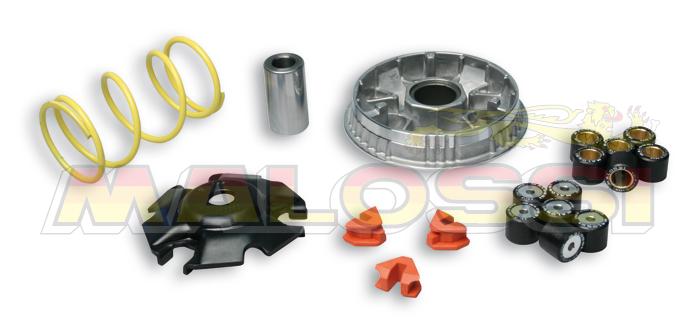

How does the multivar improve acceleration more than just setting the stock vario to the same rpm and increasing it's jump off the line with sliders that take the gearing so low on take off that shuddering sometimes begins to show?buddy1976 wrote: i really do think an after market variator kit like the nyc or malossi is a must if you want to improve acceleration without engine mods

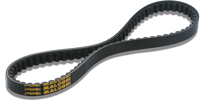

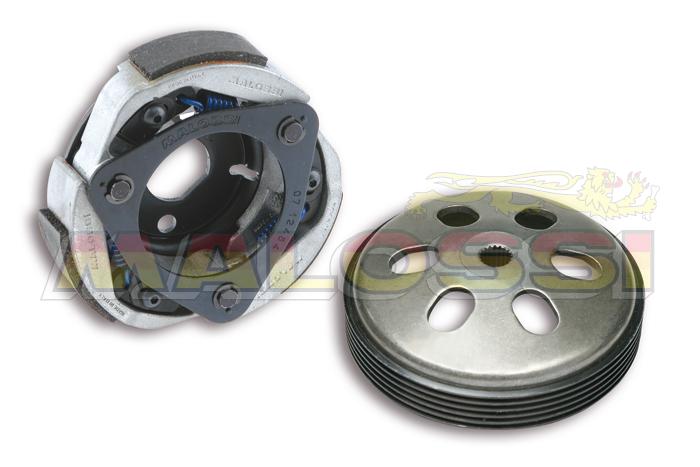

Interesting topic. I just installed a few of Malossi products last weekend. The variator, kevlar belt and the maxi delta clutch set. I notice significant difference in how smooth the take off is. It is supper smooth. Take off rpm is about 3800 and there is the power for a very aggressive take off if one wants to use it. It would be easy to dump a passenger if they were not paying attention. The weights I used are 12.5gram Malossi. I noticed that my top end RPM has dropped from:
8800-9200rpm at 100kmh to 7800-8000rpm at 100kmh
Previous top speed was 107kmh, how it is 118kmh. The speeds stated are GPS recorded. Speedo not accurate.
Generally the system, because all the drive parts were replaced, is very well tuned for a city driving as there is lots of power at typical city speeds to "goose it" to avoid a problem, get past a problem and the like. Very responsive and the fact it is still pulling at higher speeds due to lower RPM leads it to be better able to maintain highway speeds. One more thing, less vibration from the drive system at high speeds over stock. Probably due to lower RPM and better balancing of the Malossi product.
Still have more testing to do, but I think my in town mileage will drop and my out of town highway speeds will improve. Whereas in the past in town was excellent and the highway mileage lacked.
Happy Scooting.....
