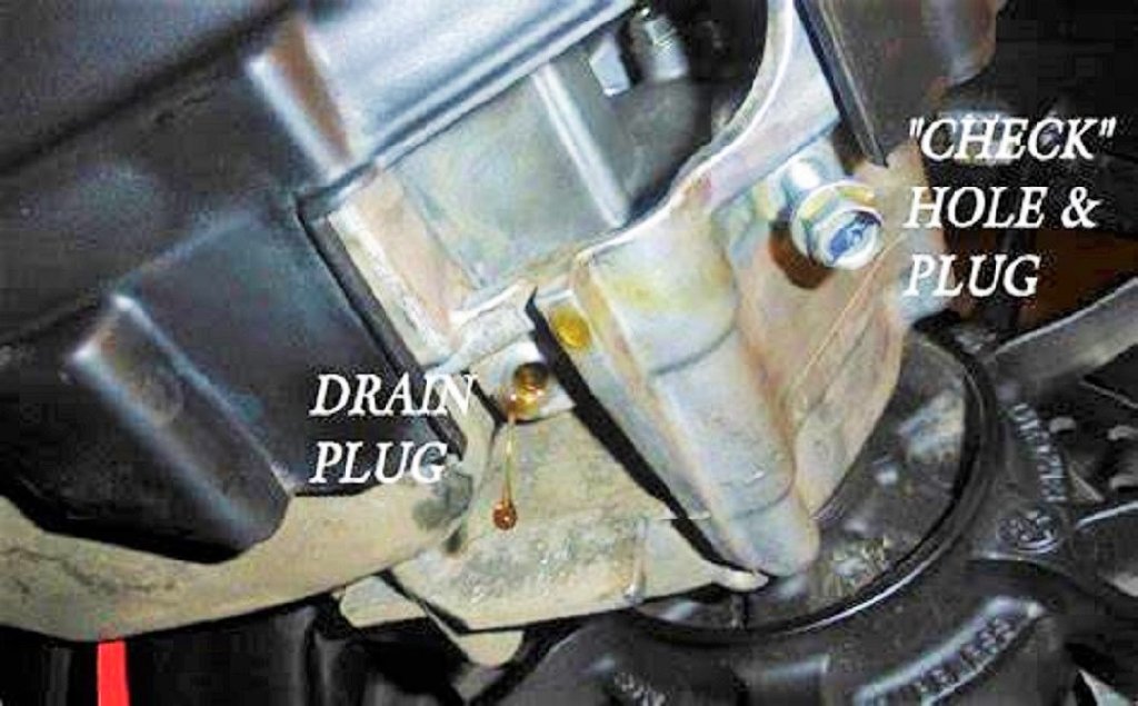

The Forza is different than my other scooter.
My LIKE200i has 2 plugs, a drain plug and a fill plug when changing the gear oil.(plus it uses heavy wt gear oil, not motor oil like the Forza)
This Forza has 3 plugs; a drain plug, a fill plug and a "check" plug.

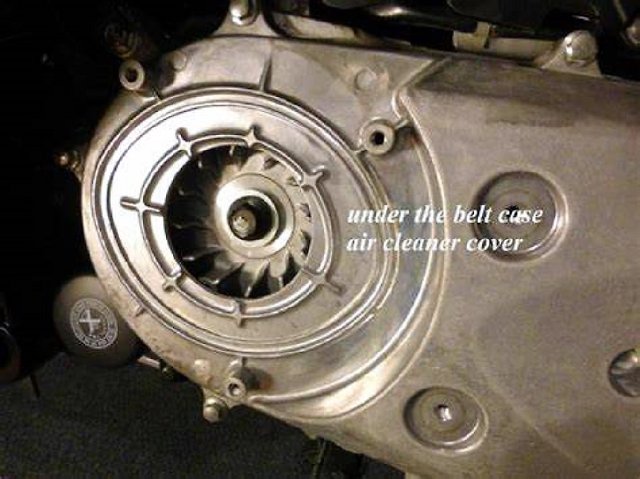

I also removed the belt cover cleaner filter and the left crankcase outer cover. Manual says to remove the latter - but I've been at all 3 of those plugs without doing so.
I do not have a ratcheting 12mm box wrench to undo the fill plug - so I used a couple extensions to reach that plug - with the ratchet handle working above the tire. It is tight in there for that one plug.
I drained the old oil (280ml came out) oil and replaced with a like amount of the specified HP4M Honda oil, using a squeeze bottle and some small model airplane fuel line, until the oil dripped from the "check" hole. This takes some patience.
All the plastic parts and the filter went into the sink with some Dawn detergent - dried and used some Honda wax/cleaner on everything but the foam filter.
There was some crud on the tip of the "check" plug that I wiped on a paper towel - looked like a few small flecks of metal. This was the first gear oil change for this scooter. The foam filter showed clearly that I rarely ride through the underbrush - or squirrels.
@@**A caution - please note the 3 gear oil plugs on the Forza. DO NOT drain from the "Check" plug (thinking it is the drain plug) while filling to the brim of the fill plug! Make certain you have located all three plugs and understand their fuction. The drain plug is not visible unless you look way under the gear case.**@@

I just looked at the factory service manual, which I kept.... the photos there are small.
Basically you locate the 3 plugs in the gear case after removing the big plastic cover.
Top plug is where you add the oil, middle plug is the proper level for the oil - in other words fill at top hole until it drains from this middle plug.
Very, very bottom plug is used to drain all the oil.....manual says to slowly rotate the wheel while doing this.
To Service The Gear Oil:
Use "Pro Honda HP4M" oil
Find the 3 oil plugs
Drain from bottom hole - replace this plug.
Fill at top hole until oil flows from middle hole
Don't get the plugs mixed up!

Found some of my original pix (on the web!) from the gear oil change of my 2014 NSS300 FORZA.
hope this helps

Re: How-To: Gear Oil Change & Belt Filter Clean
Thanks a lot Fish, that's very clear...
I'm surprised the check plug seems to be so low down, but I guess it has a long nut to make up for it.
The guy who did mine opened the bottom shock nut and moved it out of the way to get to the fill plug....
