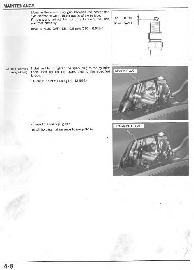

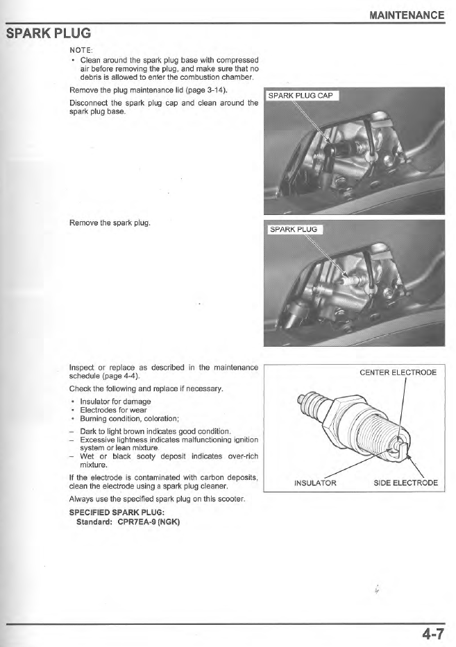

I checked through my old packet of papers from when I bought the PCX. There was no instruction manual. I found a downloadable manual from ClubPCX. The task looks pretty easy. Thanks for the tip.
Re: need instruction for how to replace a spark plug
Posted: Mon May 21, 2012 6:25 pm
by maddiedog
Ew, the Vietnamese one?
First off, make sure not to overtighten the spark plug. The spec for it is 16 N/m or 1.6 kgf*m or 12 ft/lb, which isn't much past hand-tightened.
If you buy the manual, you need pages 4-7 and 4-8. I took pics of the pages you need from the English manual:
Enjoy! ;)
