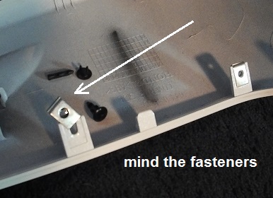

Keep an eye on your screw fasteners they like to flick away. The side panels are quit secure without replacing the two trim clips.

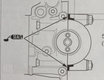

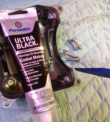

I will follow up with torque specs and any goofiness that occurs during reassembly only if there is something new to learn in the process. I need to find some gasket goop and the manual doesn't offer a brand so any suggestions would be helpful. May take a couple days to reassemble as I see a little dirt under these panels and you know how that will bug me 8)

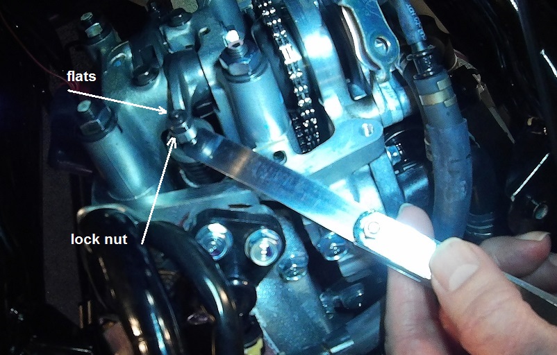

Here is a picture of the point at which you check the clearances and I do note there will be no actual adjustment footage because SORRY I don't need one :x However if you did need a little tweak there are special tiny wrenches involved that someone should show you in this thread. There are square flats on the stem and one lock nut. Loosen the nut turn the flats to achieve desired clearance then lock it back down while holding the flats on the stem in position (thus the special wrenches). Tappet wrench 3mm 07908-KE90000 (USA ONLY)

I don't use any "gasket goop"... as long as the gasket is smooth, clean/lightly oiled and torqued evenly... it wont leak.

Coming from a pro I consider your interest in this an honor. SM shows the sealer and where to put it so since I have it. But you are right it doesn't look like it would need it. And its just in the corners as shown.
