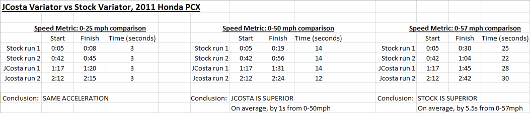

I think it's interesting how the speed just ever so slowly INCHED faster towards 61mph with the JCosta variator, then stuck there. It supports the train of thought that the ECU limits the revs at around 61mph in the USA.
I analyzed the video times the best I could to put together a JCosta vs Stock acceleration comparison:
- JCoster.png (18.94 KiB) Viewed 6965 times
With such a small sample size, it's hard to conclude anything, but it looks like
the JCosta performs same as stock accelerating through lower speeds, better than stock approaching top speeds, worse than stock at the stock's top speed, but then accelerates past the stock's top speed (probably in this case due to belt wear). I'd imagine if you replaced your drive belt, we would probably see the same top speed out of both stock and the JCosta.
My conclusion:
There is some truth that the JCosta does help acceleration through some ranges. The variator may help your top speed. But, as was concluded on ClubPCX, your speed gains will be limited to 61mph unless you change your ECU.

kinda proves its not worth it then.

It might be for some people. If you have a lot of money and want to gain a bit of acceleration to beat people in drag races, it's certainly worth it.
Losing 10 pounds or ditching the bitch riding on the back will help most people win a race more than this though.
