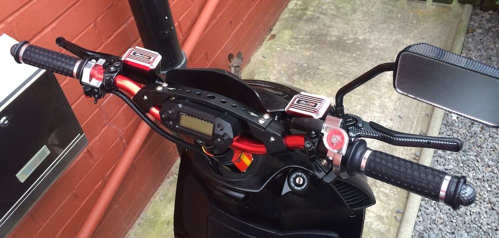

when changing your bars, keep in mind the height from the bodywork and the sweep backwards. I have a very straight and low set on mine and i had issues with the throttle cable and the banjo bolt clashing with the bodywork. also if they are too straight with no backsweep then they can clash with the screen whilst manouvering.
http://japan.webike.net/products/1757518.html
I have the medium version of these and they fit nicely but i had to customise the banjo bolt to clear the bodywork. I am also using a lower than stock front screen that only runs to the height of the dash cover. I initially tried the lower version of this bar but i couldnt run the throttle or brakes at the right angle.

Liking that Bike!! the smaller Screen looks good as well...
have to wait to get some spare money and to get my Bike looking how I want it :-(
but it's getting there, slowly!
